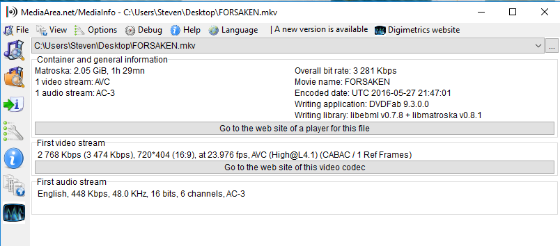

      ***If i put in the recommended 720x404 the settings are retained in the ripped/converted MKV.

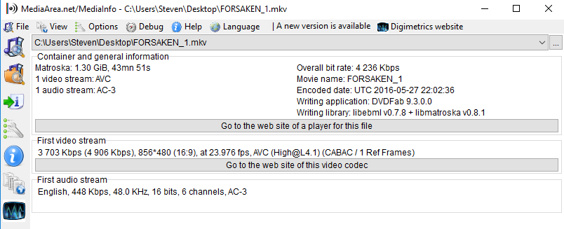

      ***If i put in the settings of 852x480 (i think technically 853, but DVDFab likes 852) that DVD players like to scale 720x480 discs to when playing, this is also retained in an ISO to MKV rip.
      -i verify the file settings using Media Info https://mediaarea.net/en/MediaInfo.

          720x480 is not a 1.78 aspect ratio. 404 is the correct height for 720 width. You can tweak the frame resolution but keep the width 1.78 times larger than the height to maintain the 16:9 ratio you want. Examples:

            Props to "SeeMoreDigital" and coincidentally "signals" in the post link below for convincing me to Rip my anamorphic DVD ISO's to "MKV-passthrough" if i want perfect quality, at the expense of large files. I am thinking i'll go with 856x480 as opposed to 720x404 since 480 doesn't lose vertical bits. yes 856 adds more unnecessary data to the horizontal (still 1 gig smaller in my test with MKV passthrough), but for the moment it is my preference. I probably won't be able to see the difference, but it will make me warm and fuzzy .
