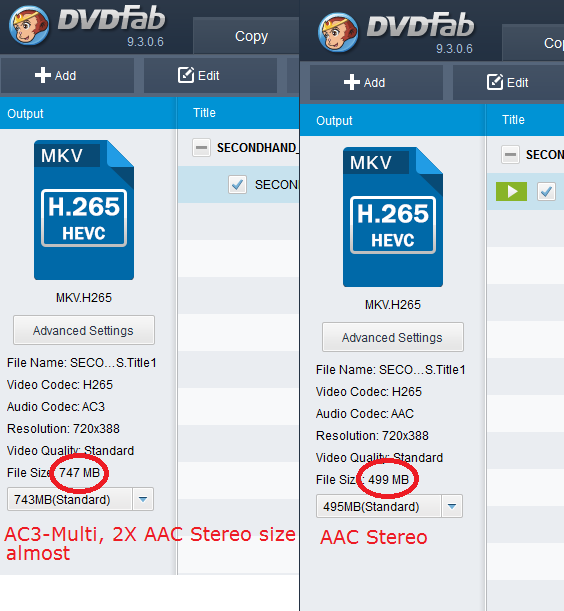

        Which quality setting do you have set from the dropdown selector on the left of the screen? For a DVD, I would recommend Fast or Standard to reduce the file size. Also, you have the audio set to copy mode, which will in some cases make the audio part of the output file larger than the video. Unless you really need the multichannel sound, try resetting the audio to re-encode rather than copy. If you set it for Stereo, the file will be much smaller. See the attached captures.
