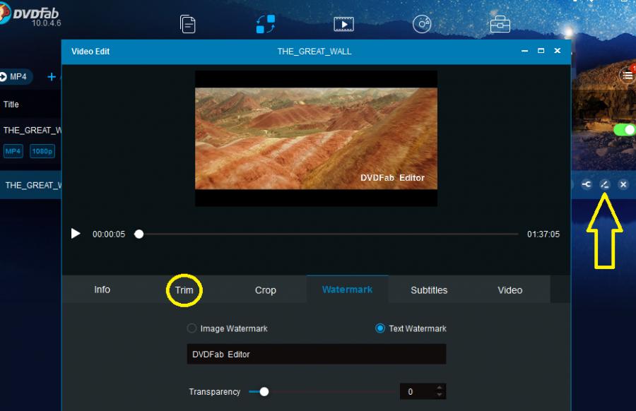

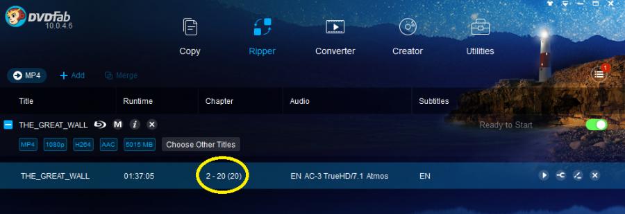

            Yes, you can chop and edit movies in Ripper, in two ways: using the chapter controls or the Editor, as shown in the captures. Hard to do either one accidentally.

              Thanks signals,
              I tried both methods & was able to remove the beginning of a movie.
              I agree this would be difficult to impossible to do accidentally .
              If someone was checking the settings & not paying attention the first chapter might get removed by accidentally selecting chapter 2. That would require paying very little attention .
              I don't believe that is what happened to edistoriverrat.

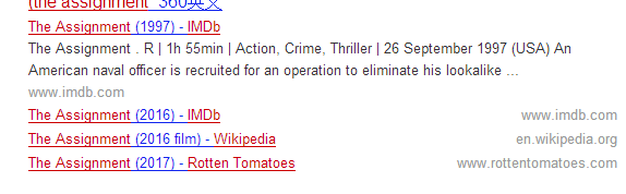

                another movie
                So far, I have found one more movie that is missing the first segment. (The Assignment)
                      What is the movie release? Is it the latest ?
