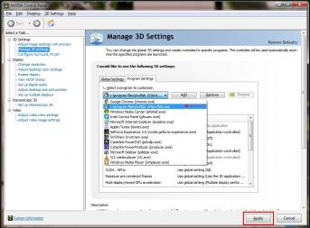

            @jessica.olson
            1. Open nvidia control panel .
            2. Add dvdfab.exe fabprocess.exe to 3d settings like show in pic below.

              Still no luck. As I mentioned, CUDA works just great with many of my DVDs and BDs, getting upwards of 1000 fps, but it will not work for these two shows (Columbo & The Red Green Show). I tried a third show (Flight of the Conchords), and CUDA worked great, but it still wont work with those other shows.
