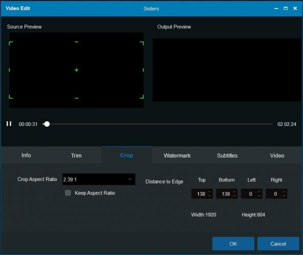

        I had the same crop problem on BluRay rip. I found that it seems to be an issue with 2.4 aspect ratio movies. If I leave the crop aspect ratio in "Auto" then it crops off center. When I set crop manually to 2.4 then the BluRay is cropped correctly. Click image for larger version
          #19
          One more step in order to fix the crop issue. In addition to setting crop aspect manually and unchecking "keep aspect ratio" I also had to use the built in encoding profiles. If I used my profile with the steps before it would still crop off center. If I used built-in profile without setting aspect manually it would also crop off center.
            #20
            very interesting. thanks for the info, I'll keep it in mind for next time, and maybe it will help dvdfab fix this problem.

                has anything been figured out by looking at my log file? Its been over a month since I submitted it, and I continue to have cropping issues, most recently with the blu-ray copy of Thor: Ragnarok included with the 4k blu-ray.

                  doing this still crops off center for me. I'm picking the MP4 profile, making a couple changes (high quality instead of standard, and AC3 audio, but that's all I'm changing. then I specify 2.39 aspect in crop settings, turn off Keep Aspect, but its still off center up and down.
                  The only way I can get a properly centered movie is to NOT crop at all, recording the black bars into the video.

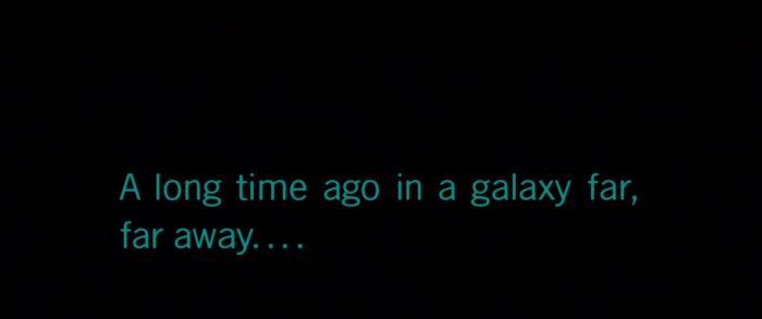

                        TESTING
                        can anyone see this image full size? should be 700 pixels wide.

                            I did some testing today based on your findings using yesterday's release of Star Wars The Last Jedi, which is yet another 2.39:1 aspect movie.
                            Using normal settings, the blu ray ripped in about 40 minutes, and was OFF CENTER...
                            (I was going to post a screenshot here, but there seems to be a limit on the attachment size on this message board)

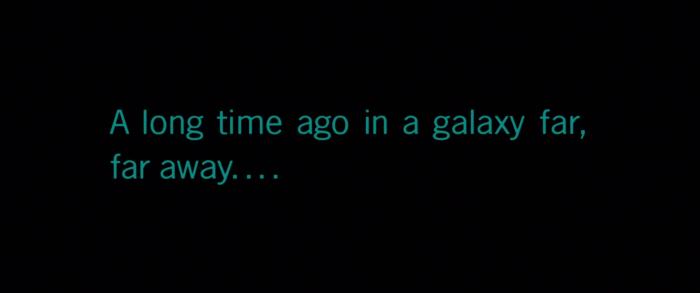

                              #29
                              trying an image host. click thumbnail for full size image...

                                I then tried ripping the movie by disabling "lightning shrink" and "lightning recode".
                                the rip still resulted in OFF CENTER crop.
