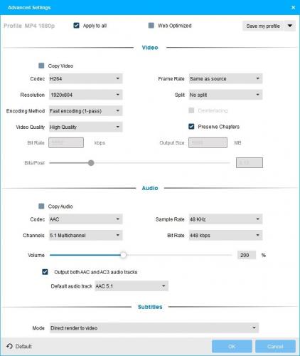

    When I set all of the options to use CUDA it appears to rip the movie but says Success after only a couple of seconds with nothing actually being ripped. Am I missing a setting somewhere? Below is what I have for the Ripper Settings and the Common Settings\General\A/V Codec is reporting I have installed.
Name:	Capture 2017-11-22.jpg

    Hi racathra,
    Sorry you are having an issue. You are using normal settings. Does this happen with all titles? Any difference if CUDA is disabled? Current (v10.0.6.8) version installed? If so, please attach the following: 1)fabcheck log 2) DVDFab internal log session for one of these instant conversions. Instructions are linked in my sig, below.
