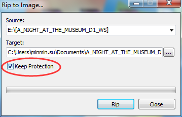

                            Please use Passkey to create an P-ISO file from one of the problematic disc and send it to us to help check the problem. Thank you in advance.
                            Passkey can be downloaded at: http://www.dvdfab.cn/download.htm Click image for larger version  Name:	rip to image with protection kept.png Views:	1 Size:	21.7 KB ID:	363677
