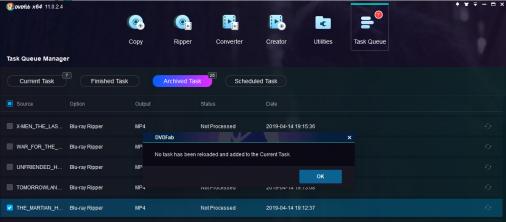

    3. Reload button on Archived Task screen doesn't work. So I have a list of tasks in the Archived Task. I selected a task by clicking the checkbox in front of it. I verified all the source folder and drive were still the same. I clicked on Reload button at the bottom of the screen. DvdFab would then give me the following error:

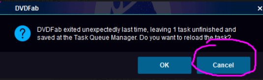

      For the third one, when DVDFab reports to reload the tasks, do you click on "Cancel"? If so, the tasks cannot be reloaded. See attached.
