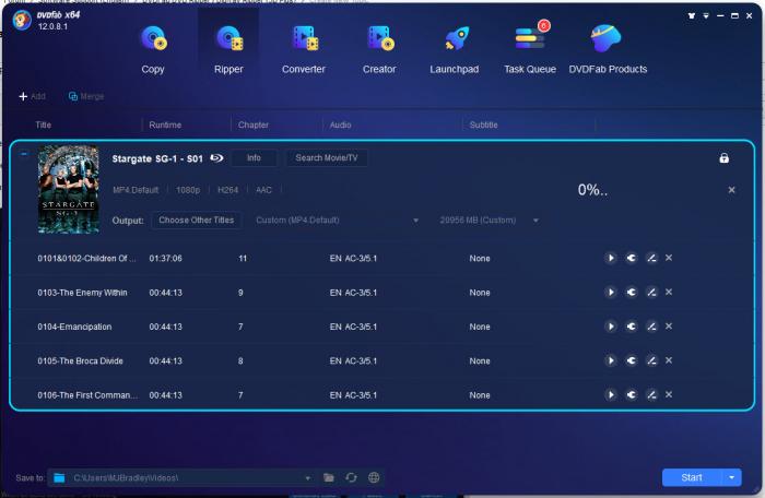

    I've been using one version or another of blu-ray ripper for many years, but this is the first time installed on a windows 10 machine.
    I selected 5 titles from the Stargate SG-1 BD's I just got and it's been on 0% for 23 minutes.
    Any thoughts?
    Click image for larger version  Name:	DVDFab 8-6-22 1a.jpg Views:	0 Size:	33.9 KB ID:	413357

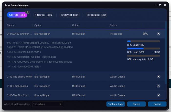

    Click image for larger version  Name:	DVDFab 8-6-22 1b.jpg Views:	0 Size:	34.6 KB ID:	413358

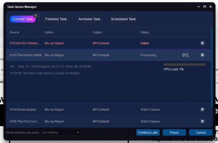

    aaaaand, failed after 31 minutes
Name:	DVDFab 8-6-22 1c.jpg
    The logs should be fresh. Please let me know what I can post to help find the issue.
