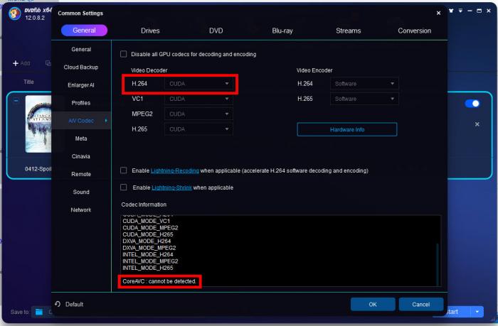

        CoreAVC is not supported. About the not using CUDA problem, please enable GPU and repeat the process, and then zip the whole log folder and send it to us, the developer will check why it doesn't use it.
          #19
          As far as the CoreAVC issue, it can be seen at the bottom of the first image "CoreAVC: cannot be detected". Again, even the last version of this I can find a reference to is from 2011, and I can't even D/L that version (3.0.1.0). I have v1.9.50 installed.

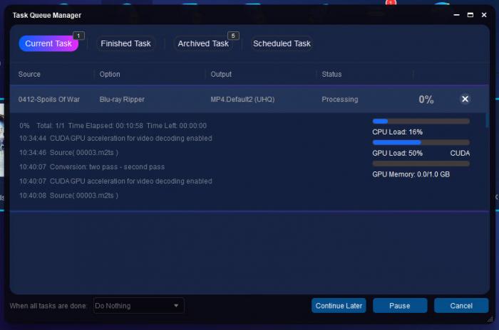

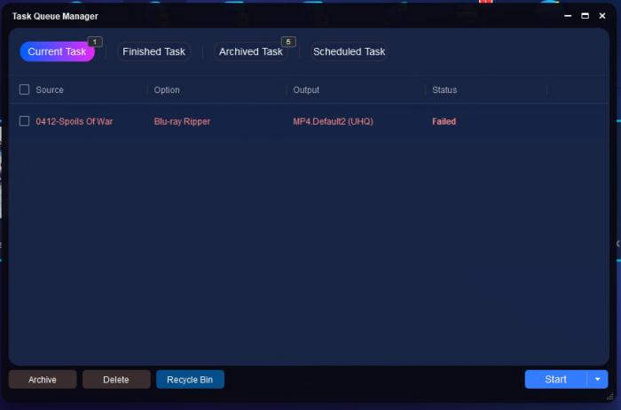

          These 2 images are for the process of using CUDA (selected in the first image) for a single episode of Stargate Atlantis.
          Click image for larger version  Name:	DVDFab 8-10-22 1b.jpg Views:	0 Size:	28.7 KB ID:	413514
          Click image for larger version  Name:	DVDFab 8-10-22 1c.jpg Views:	0 Size:	18.9 KB ID:	413515
          It went about 30 minutes of Time Elapsed with a slight load on the CPU & GPU, but never left 0%.

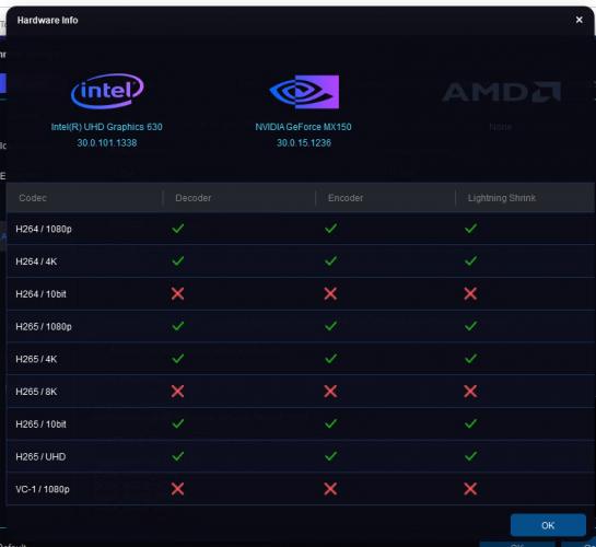

                #22
                The developer said that the Nvidia M150 is special for notebooks and it doesn't support to use in this case, he suggested that you use Intel.
                As for the "CoreAVC cannot be detected" issue, I am afraid that there is no plan to solve it at the moment.

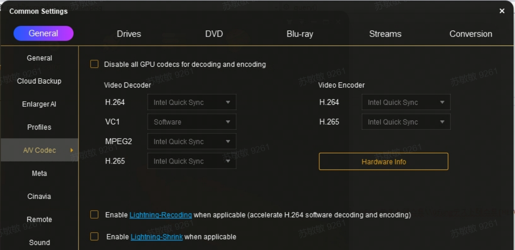

                    Please refer to the image to adjust the Coder settings to have a try.

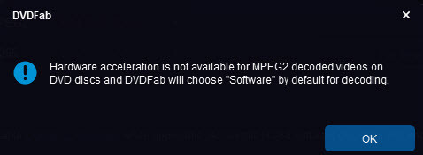

                      Those are pretty much my current settings, except MPEG-2, which wants to stay as "software".

                        You may just ignore the MPEG-2, it doesn't use that much now, h264 is used more frequently.
                          #27
                          Yeah, I use MPEG-2 occasionally in PowerDirector for certain exports, but not much.
