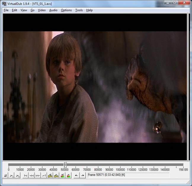

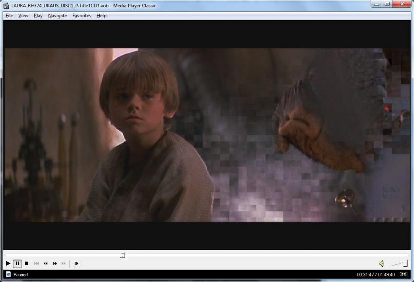

    I was ripping the UK version of Star Wars: The Phantom Menace using VOB Passthrough to get the original decrypted vob files with DVDFab 7.0.8.2 and I get one very obvious frame of corruption (images attached (goodframe is the frame after the corruption)). It is always exactly the same frame that is corrupt.
    I tried ripping the same DVD using LightningUK's DVD Decrypter and encounter no such corrupt frame at that point.
    I have tried cleaning the disk and ripping multiple times and I always get the same issue at the same point.

    Well for starters the good frame you posted is not good as well it has corruption also from what I can see. No problems with the Region 1 Canada version of this DVD or the rest of the Star Wars DVDs I have. What we need you to do is read what is listed below and post all info to your next post reply to this thread

      I am not quite sure what other information I can provide that would be useful. Please find new images from VirtualDub that have been indexed using DGIndexNV so you can see the exact frame number. You are right the "good frame" from last time was also not good, that was more to help you find the part of the film that's corrupt.

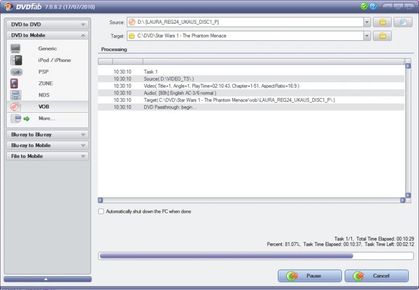

      Source: Star Wars - The Phantom Menace (LAURA_REG24_UKAUS_DISC1_P is disk volume name)
      DVDFab VERSION: 7.0.8.2
      DVDFab PROFILE: vob.passthrough (only change is splitting at 4gb, but already tested that that doesn't make a difference)
      Computer: Windows 7 (32 bit), copying to NTFS C: drive, Intel Core Duo 2, Samsung SH-B083L drive, 4gb RAM.
      Couldn't find any relevant logfiles, I will re-rip and post them.
      There are no errors, warnings, etc. I will keep testing to try and workaround it - as I really like DVDFab but will need to stop using it if it can't even do a vob copy without causing corrupt files.

        Are you doing the VOB passthrough straight from the original DVD? If that is correct then you should try ripping the DVD using Main movie and save to hard drive as if I remember correctly VOB Passthrough only does main movie. Then with the saved file on hard drive you use that as the source to create your VOB using the VOB passthrough
          You mean do DVD->DVD Main Movie and then try a DVD->Mobile vob.passthrough? I will give that a try.
          Yes it is the original DVD. I just tried ripping and turning off all the protection removal other than CSS (i.e. turned off path player, Region removal, etc). It didn't help - same bad frame.
          Then I tried loading and enabling AnyDVD so it could do the decryption part and DVDFab just do the ripping of the, now unprotected, files. That worked and the file did not have the corruption.
          Makes me think there's some sort of error in the DVD decryption code or similar...
          NobodyGood
          EDIT: Interesting: I did a DVD -> DVD Main Movie copy and the VOBs on the HD didn't show any error? Not sure why that would work and vob.passthrough would cause corruption. Strange bug.
          EDIT: Latest Beta doesn't fix the bug.....
            Just tried a DVD -> Mobile encode using AVI (generic.avi.divx.audiocopy). I get the corruption at the same frame (50571). So, it's not just vob.passthrough, I would hazard that all DVD -> Mobile can cause this minor frame corruption.
