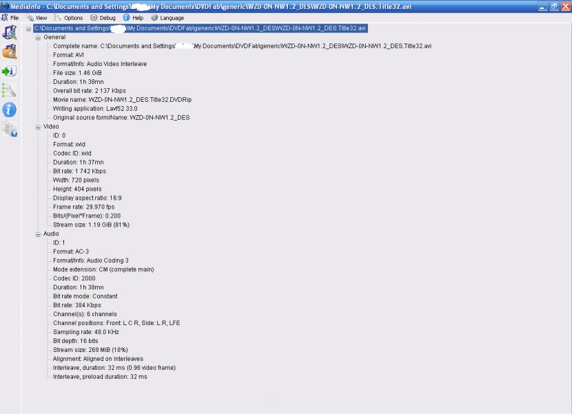

                  I as well got the xvid for the divx default setting (generic.avi.divx.audiocopy). I posted the Mediainfo as an attachment as well
