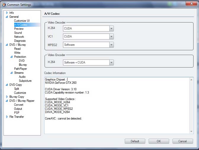

          The settings are DVD "to MKV", 2 pass, copy audio, 720x, bitrate .500, and CUDA options, however I don't know how relevant they are as like I said it works for me in v7, doesn't in v8 with the exact same settings.
          Hope this helps identify the problem; I am not really interested in bug testing, but I can try a few things I guess, if it will help Fengtao identify the code.
            Hi K1LL3M,
            Please try to install DVDFab 8.0.2.3 Beta at
            to rip dvd episodes.
            You can open Common Settings->General->A/V Codec, set video decoder as software and set video encoder as software to rip DVDs if you still have the same freeze issue.
            Kind regards,
            sunny

              I downloaded 8024 (8023 links to this) and tried with this version and problem is still there. I tried with both cuda and software en/decode options but it made no difference.
              At 0.23% it stops
              FPS slowly decrease down to zero
              Elapsed time continues to count.
                Have tried again with 8028 and DVD to MKV still does not work. (as above I am converting TV episodes from DVD)
                There has been a slight change that I think is related to the CUDA bug in this release., though I dont know if it will help with anything
                Using software coding, MKV will still hang at 0.23%, elapse time keeps counting and FPS counts down until at 0.00. Which is the same as before.
                The difference using CUDA is that it hangs at 0.17% which is the only difference, all else is the same, just like above.

                        I haven't done much with BR Ripper recently, but without a doubt, v.8.xxx has been very buggy.
                        I just tried Armegeddon as a test...used 8028 Beta,
                        mkv.h264.audiocopy, fixed bitrate @ 10,000 kbps.
                        Also, since I've never had any luck with BD 2-pass ----> mkv,
                        I've used 1-pass for quite some time and frankly, I don't see a difference between the two, quality-wise anyway.
                        The hdd files playback just fine and no av sync issues.
                        My A/V Codec settings are:
Name:	AV Codec.jpg
