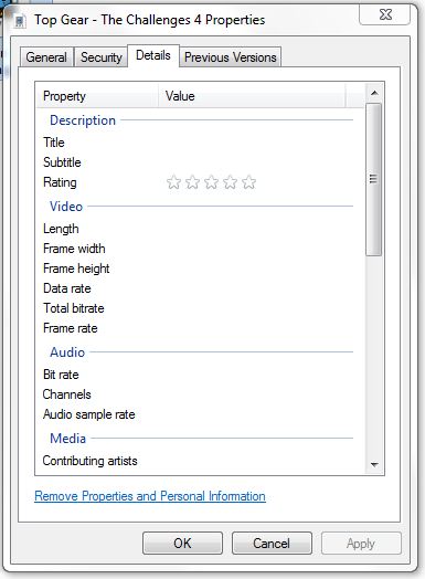

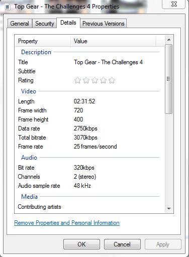

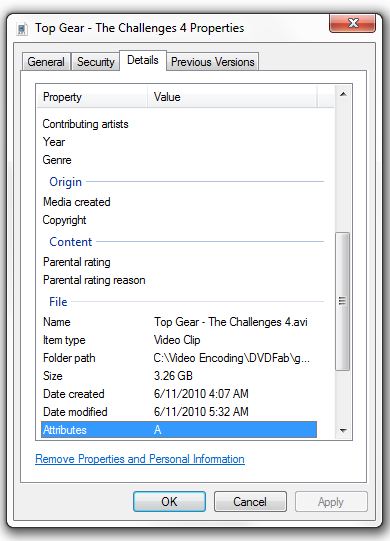

          Attached are screenshots of my file properties for both 8.0.2.2 and 8.0.3.2 in which you can see both are 3.26GB in size but the 8.0.3.2 file properties have no info about video audio etc.

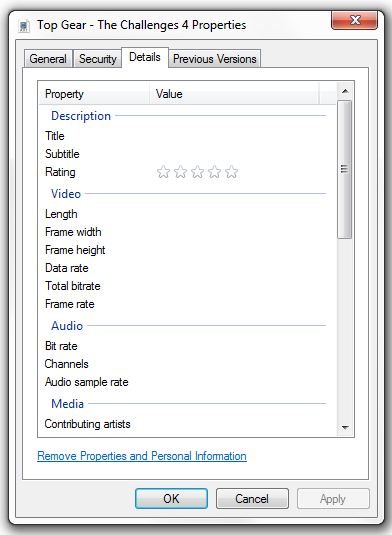

            A Couple things I have noticed:
            1. If I double click the file nothing happens
            2. If I try to open it from within WMP12 I can force it to play i.e. it doesn't want to open it but you can say "open anyway", it takes while but it eventually will play it.
            With every version between 6.2.1.8 and 8.0.3.2 everything works as normal, meaning - full file properties, open with double click no force necessary.
            Attached below are screenshots of the following:
            1. A Thumbnail of an 8.0.2.2 divx avi showing its thumbnail - Everything is as normal with this file.
            2. A Thumbnail of an 8.0.3.2 divx avi that is unable to generate a thumnail
            3&4. Blank File Properties of the file without thumbnail
            You can see the file properties of my working 8.0.2.2 file in my post before this one

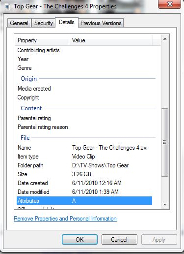

                              If possible could you also just check a couple other things for me?
                              1. Does your fresh rip contain all of its file properties or are they empty (right click - then in you details tab)
                              2. Does you new file display a thumbnail preview?
                              Examples of what I'm currently getting are found in posts 5 & 6 of this thread:
                              Post 5 -
                              Post 6 -
                              thanks for your help
