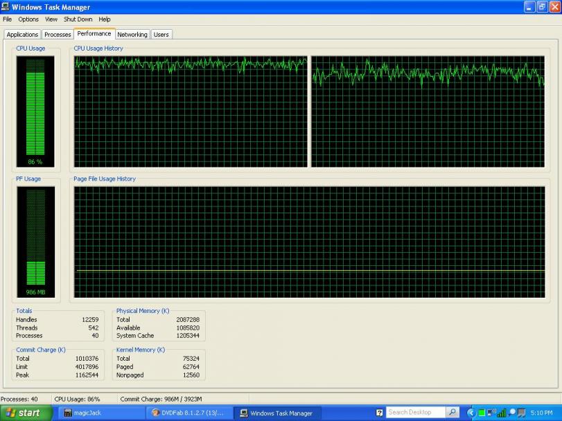

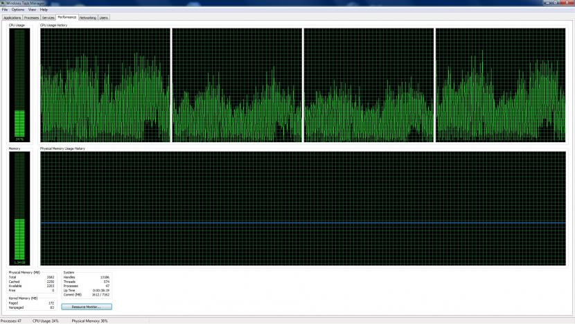

                        I ran across some unusual behavior trying to reproduce this issue. I did Transformers 3 on my XP SP3 laptop and I could not reproduce the problem. Both cores of the dual core stayed engaged and the fps held up all the way. So I tried on my W7x64 quad core and the CPU cycled wildly, the fps dropped until it took longer to complete than the dual core XP machine. Just really odd. Same movie, same profile generic.xvid.audiocopy all settings the same.
                          This is a real problem that I noticed back in the summer when making new rips of some old 4:3 movies for my iPad. Just as Cybmole describes, the conversions stop at odd spots when the decoding fails. I finally sent sample files to Beijing and I thought it had been fixed. It never fails with newer widescreen movies. The problem may be with the VIDEO_TS folders that were made by an unknown version of DVDFab. I will test a couple of them tomorrow if the football TV schedule permits. The ones I did didn't fail until 30-70% complete, but they all would complete fine with v8.0.7.3.
