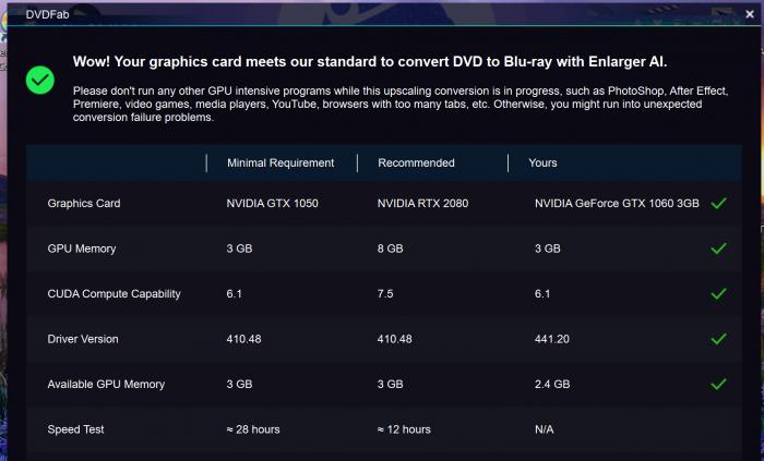

    This doesn't use my Cuda and CPU/GPU meter doesn't work with it.Using GTX1060 3gig fab says my card can handle it and it did..Some of the info. says you need more than 3gb memory on card but other posted info. in the sticky note say 3gigs is ok so somewhat confusing.Fab softwear says all my equiptment ok when using it.

            The read speed is not related to the menus at all, it is a function of the way the disc is authored and where on the disc the VOB files are written. Close to the spindle is slower because the drive reads fewer sectors per revolution than it does at the edge. For most DVDs the highest speed is nnormally near the layer break. Your present setup is closer to the minimum requirement, so I think you can expect times near 28 hours for a typical movie.
              Signals: So you say 28 hrs. for a typical movie for my setup I assume you mean with Cuda that isn't working now correct?
                Yes, the 28 hours would be expected with working CUDA. I note you do not have the same driver as the testbed, have you tried changing it temporarily?
                  Hi, I've the same problem. When I start the process It show me a message "Wow! Your graphics card meets out standard to convert DVD to Blu-ray with Enlarger AI.", and I have a GTX 1080, 8 GB GPU Memory, 6.1 CUDA Compute Capability, 440.97 Driver Version and 6.6 GB GPU Available GPU Memory, so it's ok. The problem is that CUDA doesn't activate, so the conversion is impossible to complete (only the CPU work to convert, not my GPU), after many minutes of start the FPS reach 0 and the conversion stops In all other function the CUDA works perfectly and the GPU is used, but in Enlarger AI only CPU works. Please help us, I just buy the complete suite also for this new function. Thanks.

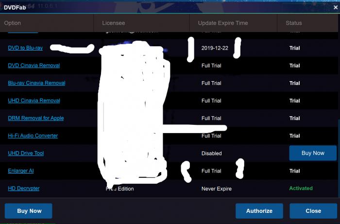

                        I noticed In licenses screen that I have a trial of dvd to blu ray with 12-22-2019 expiration date but under license for AL it says full trial as if its not active.
                        Don't know if this makes a difference as when trying it the dvd to blu ray part works and says checking for new AL files and it finds new files then starts but like I say no cuda and seems the AL doesn't start as no log file for it.
