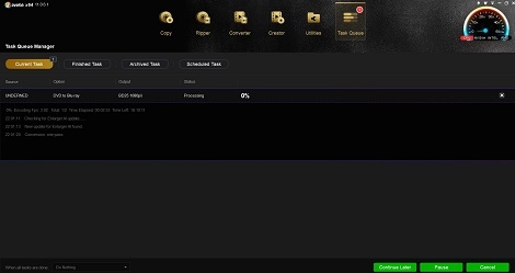

    Tried converting dvd to bluray using enlarger AI module. It takes longer hrs. Please check the screenshot. Also attached log files too.

          Please find attached screenshot and logs for your reference.
          Version : dvdfab 11.0.6.1
          Its says wow your graphics card meets our standard to convert dvd to bluray with Enlarger AI.
            That's perfect, thanks. The development team for Enlarger AI will try to duplicate the problem and report back to you here ASAP.
                I have checked log, for the graphic card 1060, this should be the normal process speed, we test it in our 1660ti graphic card, which need spend almost 400 ms to process one frame.
