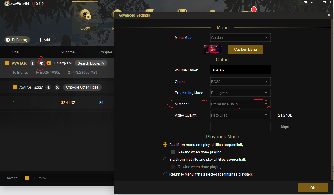

                            Hi ,
                            Your can change AI Model in Advanced Settings, and I PM your how to retry download model.
                            Yours,
                              the directions from the PM fixed the problem with Copy AI
                              thank you Wilson
