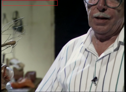

    As I say in the title, Enlarger AI inserts a faint rectangle on my conversions. I didn't have this problem with previous updates, but they are cropping up now?
    It's not just playback programs. It's actually embedded in all the videos I have tried!

ID:	379855 I'm including an image to show what I mean & you will see the problem at the top of the screen.
    Are you using the latest version (in DVDFab v11.0.8.1) or a previous one? Also, what is the Source file type ( if it was a DVD, was it an original disc or a copy, and if a copy, was it previously compressed)? I can vaguely see two stacked rectangles in the upper left area.
      Currently using 11.0.8.1. The same thing appears in the last 2 releases. That particular image is from an SD documentary on a Blu-Ray, but as I said in my original post it is on everything I have tried. I've tried every compressed and uncompressed format I can think of. I've tried it on videos from DVDs, Blu-rays, ones I transferred from VHS, as well as downloads from YouTube?

                hi, where is the faint rectangle, I cannot see it from your screenshot.

                is the place where I mark it ?
                  Yes. That's where it is.

                    ok, got it. so this image is created by DVD 2 BD, I will check the log.
                    and we will plan to update the model in the future version after OpenVINO version released

                        sorry for the not clear information, I have checked the log and know the problem, thanks for the report.
