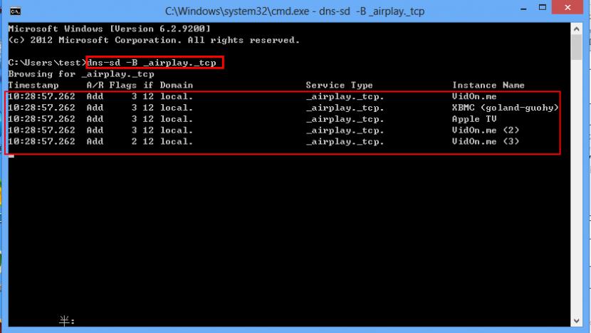

                Hi geordyuk,
                You can use commandline "dns-sd -B _airplay._tcp" to check whether bonjour is working or not.
                  hi i have typed that into the command line and get an entry back that it is running? but still no luck any ideas?

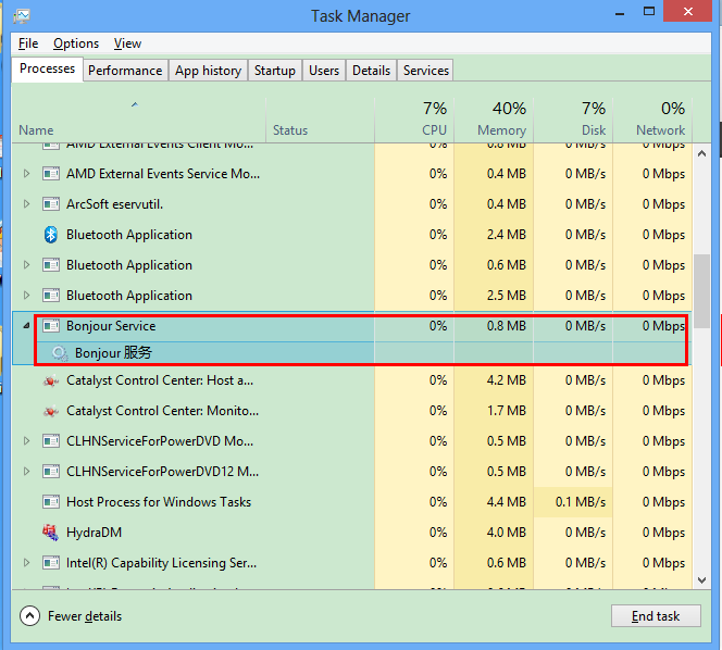

                        I have upgraded to the latest version I am using windows 8 pro (64 bit) if that's any help, I do not get any bonjour icon in task tray e.t.c and I have checked the firewall to make sure local traffic is allowed for bonjour
                        thanks very much!
                          Bonjour is running in background,which do not make an icon in task tray. You can find it in Task Manager.
                            thanks yeh its listed there! itunes allows me to stream to my at3 so bonjour must be working
