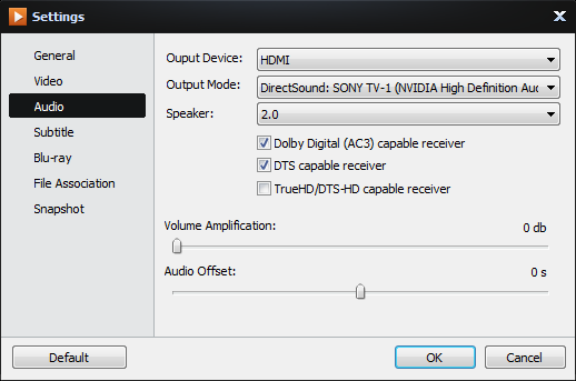

    which audio output device is your selected ?
      I tried HDMI directly connected to my TV, also tried optical to AV preamp
        I think my friend Ting means which one is selected on the Audio tab in Settings.
                I had to read the instructions on posting images.
                  You need use WASAPI instead of DirectSound output.

                    I get the same results as stated above. I tried the setting you suggested before I opened this thread. I retried the setting and I am still getting no audio with English-DTS-HD MA .
