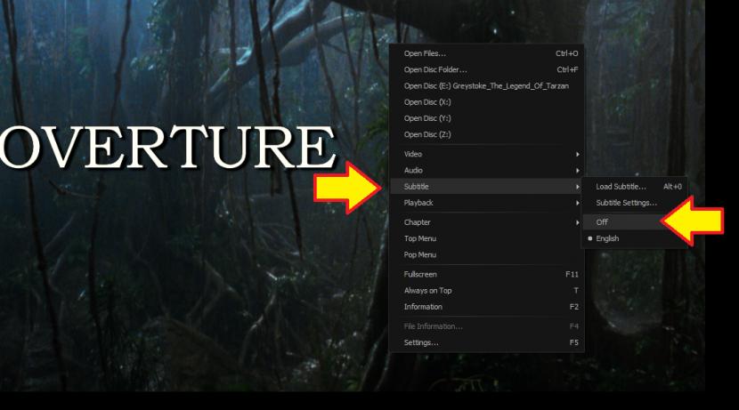

        The control for this is in Fab Media Player, not in DVDFab v9. See the attached screen capture. Right click while a movie is playing or paused to access the menu and select Subtitles, then select Off. This setting will be remembered and will disable all except forced subs until you change it manually.

              The directions in my earlier post work as stated, I just tried them. What problem do you have, subs all the time, or no subs ever?

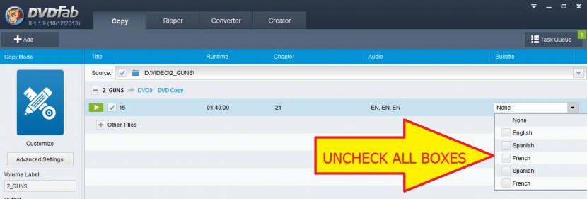

                Suppose u don't use dvd media player and are streaming to another device. It would be nice to turn off subtitles when ripping or at least have the opportunity to do so. Pervious versions had that capability. (using v 9.1.1.9)
                  You can of course do that in Main Movie or Customize modes, just select "none" in the subtitle dropdown. See attached image.
