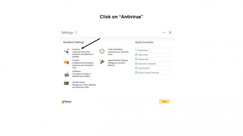

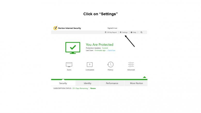

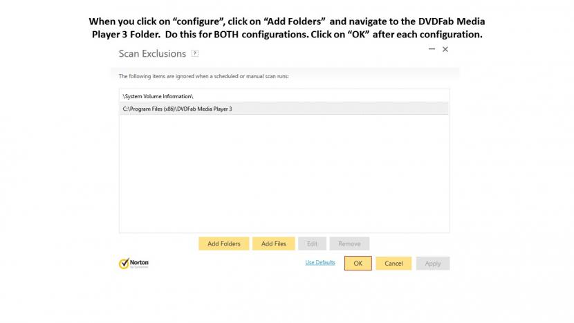

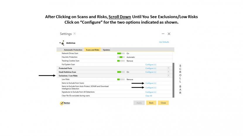

Looks like the culprit is Norton. The attached screenshots are intended to be helpful but are by no means all inclusive. If you are not comfortable changing settings to your Norton software, Norton provides lifetime support and they will remotely make the necessary changes. Tell them you trust DVDFab and the quarantining is unjustified.
I realize there are many Norton products but I am using Norton Internet Security. Make the necessary adjustments for your product and if you are unsure what to do, call Norton. With the changes made, Media Player 3 is now working and stable.Last edited by Jeffie; 03-22-2017, 03:00 AM.
