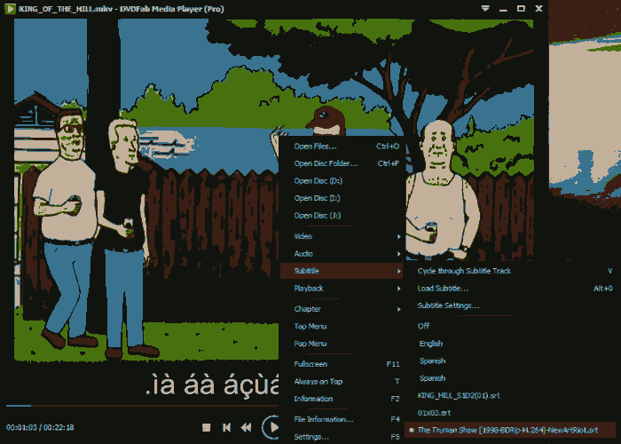

              When I use the "Load subtitle..." feature in DVDFab Media Player .
              The list shows the external.srt by name and it is the one selected.
              I tried a .srt from the linked site. I wasn't able to find one that was for the TV episode in Hebrew .
              I looked and found a .srt for a different show in Hebrew.
              It displayed subtitles in Hebrew.
              Here is an image of DVDFab Media Player showing this: Click image for larger version  Name:	KOTH(2).png Views:	1 Size:	18.5 KB ID:	344659

                  @ 90312 ,
                  The writing in your image looks more like what I thought Hebrew writing did.
                  If you check ElvisC's post #9 .
                  The .SRT sample posted . The writing looks the same as the .SRT I downloaded from the subtitle site ElvisC posted a link to in #20.
                  That is what the writing in the subtitle in the image I posted in #21 also looks like.
                  Since I don't read Hebrew I don't know .
                  Maybe ElvisC will enlighten us on the difference.
                  BTW I wish I could post an image at 130.5kB like yours.
                  Instead of 18.9kB like the one I posted in #21.
                  It can be read though so better than the ones I was posting before.
                  That the forum software was downsizing.

                      @ 90312 ,
                      I also used the downloaded subtitle that wasn't a match for the video but was supposed to be Hebrew.
                      I wonder if I don't have the correct font for Hebrew on my OS.
                      That may be why subtitle looks the way it does in the image I posted.
                      I'm going to look into it.

                          Hi ElvisC,
                          Do you know if I need to have a Hebrew font in my OS for the Hebrew to work correctly ?
                          I take it that the subtitle in the image I posted doesn't look like Hebrew.
                          The image "letters" look the same inside the .srt file I downloaded.
                            #28
                            You just need to set the charset to something like windows 1255 and it should be fine

                                I gave that a try but still the Hebrew subtitles are "gibberish" .
                                The only way I have been able to open the .SRT file in Hebrew is with Notepad++ but it doesn't "Save as" to .SRT.
                                I also tried the Font file Mona linked but it didn't fix it either.
