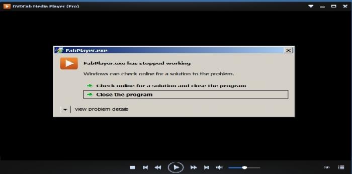

    I will start with Media Player 3 .
    I have a license key for it.
    It installed correctly with no problem.
    It does this with all files but this was just .mp3 file .
    All media files I've tried crash it.
    I have another computer that doesn't do this.
    One computer has Windows 7 HP SP1 32-bit. (The one that works)
    One computer has Windows 7 Pro SP1 64-bit. (the one that fails) Click image for larger version  Name:	DFMP3Error.jpg Views:	1 Size:	20.6 KB ID:	351413

          With DVDFab Media Player 3 Windows displays the message in the image posted in post #1 on all files .
