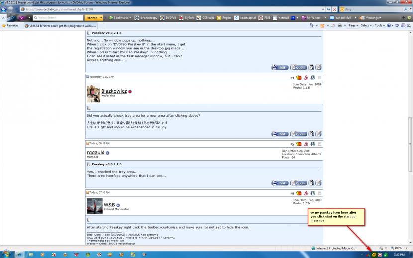

      Nothing... No window pops up, nothing....
      When I click on "DVDFab Passkey 8" in the start menu, I get
      the registration window you see in the desktop.jpg image....
      When I press "Start DVDFab Passkey" -> nothing....
      I can see it listed in the task manager window, but I can't
      access anything else....
        Did you actually check tray area for a new area after clicking above?

          Yes, I checked the tray area...
          There is no interface anywhere that I can see...
            After starting Passkey right click the toolbar>customize and make sure it's not set to hide the icon.

                No interface is started until after passkey is running. The interface is located in the notification bar and just a little icon that you right click to see choices. Check out the attachment I attached. If you do not have that icon I would suggest that you remove passkey from computer then download again to install a fresh new download
