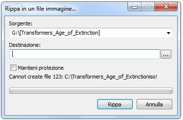

    Can not rip to HD or ISO. The problem looks to be a forbiden character in disk title. Had the same problem a while ago with the Hobbit.
    Attached are screenshots and here is the log just in case.
    Please help.

                Yes I see. But if you look at my screenshot, there is a square (forbidden character?) at the end of the disk name. That prevents any writing to the HD - folder structure or iso. I am on Win XP pro

                    The problem should be caused by the forbiden character, just rename the output name.
                      the problem is I can not rename the output name. I tried

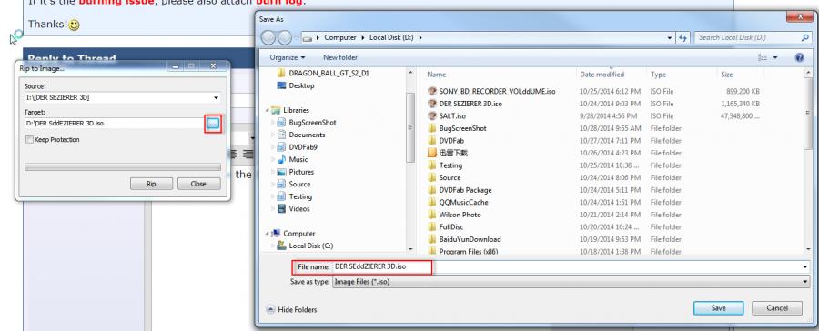

                        We can raname the ISO name when ripper to ISO. See my screenshot.
                          Thanks, I'll try this. I am on XP though
                            You can also just type in the Target box to change the drive/path/filename. See attachment.

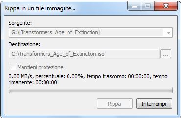

                              When you choose the name (or destination path) of the file .iso , you must clean all Text box and write from 0 the destination path + name of the file.
                              Attention : the window for choose path from the button (this --> ... ) doesn't work so you must do all in the TEXT BOX .
