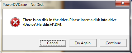

    Having trouble with 9.2.1.5 and PowerDVD 17 on Windows 7. With Passkey installed, every time I launch PDVD I get the attached message, even when there actually is a disc in the drive. Even though the error is a PDVD one, with Passkey not installed I don't see the error.

    Actually, there are four sequential errors, all identical except the "DR" reference to the harddrive. (The next one is DR5, then DR6, then DR7.)
    I have the installable for the previous version, where this error didn't occur. If I roll Passkey back, and ignore the auto-update, will it still function?

    I tried rolling back to v9.2.1.2 with no ill effects.You can turn off the update checking in Passkey Settings.

          I've tried removing the driver, and the problem goes away. It doesn't recur with another version of PDVD (such as PDVD 16, which I've now reinstalled) or any other version of Passkey but 9.2.1.5.
          I realise the issue might be occurring in the presence of other items on my system, but the key seems to be that I only get the errors when Passkey 9.2.1.5 is installed.

              I'm very happy to report that 9.2.1.6 has resolved the problem, at least for me. No more "no disc" errors in PDVD 17.
