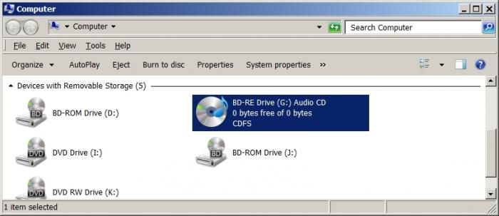

    When Passkey is enabled & a commercial Audio CD is in one of my drives Passkey has problems.
    First it doesn't read the Audio CD correctly.
    There is an Audio CD in this drive.
    This is what it shows: Click image for larger version  Name:	Passkey(01).jpg Views:	1 Size:	106.7 KB ID:	360101

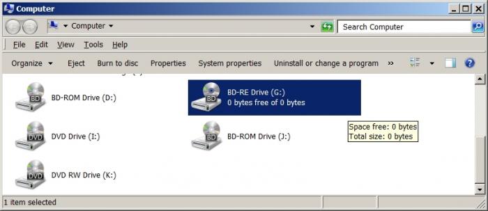

    This is what Windows Explorer shows with Passkey on:
    Click image for larger version  Name:	Passkey(02).jpg Views:	1 Size:	29.2 KB ID:	360102
    This is what Windows Explorer shows with Passkey off:
    The commercial Audio CD is properly detected by Windows Explorer.

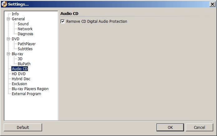

    Click image for larger version  Name:	Passkey(03).jpg Views:	1 Size:	30.2 KB ID:	360103
    This is how I have Passkey set:
    What I expect Passkey to do is "Remove CD Digital Audio Protection".
    If Passkey shows "No Disc in drive" as above I don't see how it is removing CD Digital Audio Protection.
    I hope this can be explained to me.

    BTW in case someone notices the images for Windows Explorer were done in a different drive.
    Both drives looked the same & I was testing to see if a different drive would work with Passkey.
