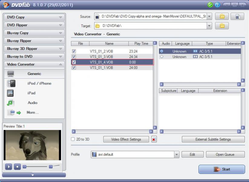

    I've 6 VOBs generated from a normal episodic DVD. The idea is I create these VOBs, then use DVDFab to convert them to AVI.
    Trouble is when i stick these VOBs into the the video converter, DVDFab thinks 3 VOBS have 0:00 length running time. The other 3 are fine and convert how they're supposed to. I put these VOBS (the ones DVDFab think are 0:00 long) into VLC and they play fine - running time in VLC is around half an hour. I've tried converting them in DVDFab, but DVDFab just goes to the encoding screen and sits there doing absolutely nothing so i have to end task DVDFab

        Do you have the .ifo files also?
          hi yes i do - they're in their own VIDEO_TS directory with the .VOB file.
            Video Converter is file based. You are trying to convert folder based content, which requires the Ripper module to read the IFO files and stitch the VOB pieces together in the proper order.

              Hi all,
              This is a known issue in Video Converter, our devs are working on it, we will fix ASAP.
