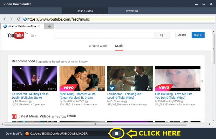

    It may be that the default storage location is not available in XP, so try setting it for a location that you know you can access. As shown in the attached capture, I set up a folder on my desktop for the downloader to use. You have to be connected to an online source for the download target option to become available.
