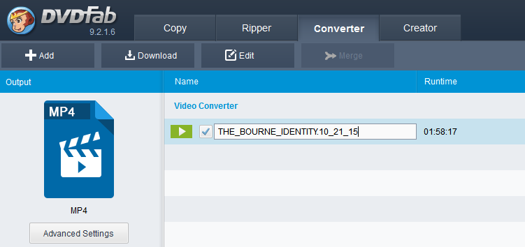

    They are given the creation date because that is when they are made. There are two possible workarounds for this built into DVDFab:
    1) Put the original creation date in manually in the filename for each one, as shown in the first capture. Only takes a few seconds.

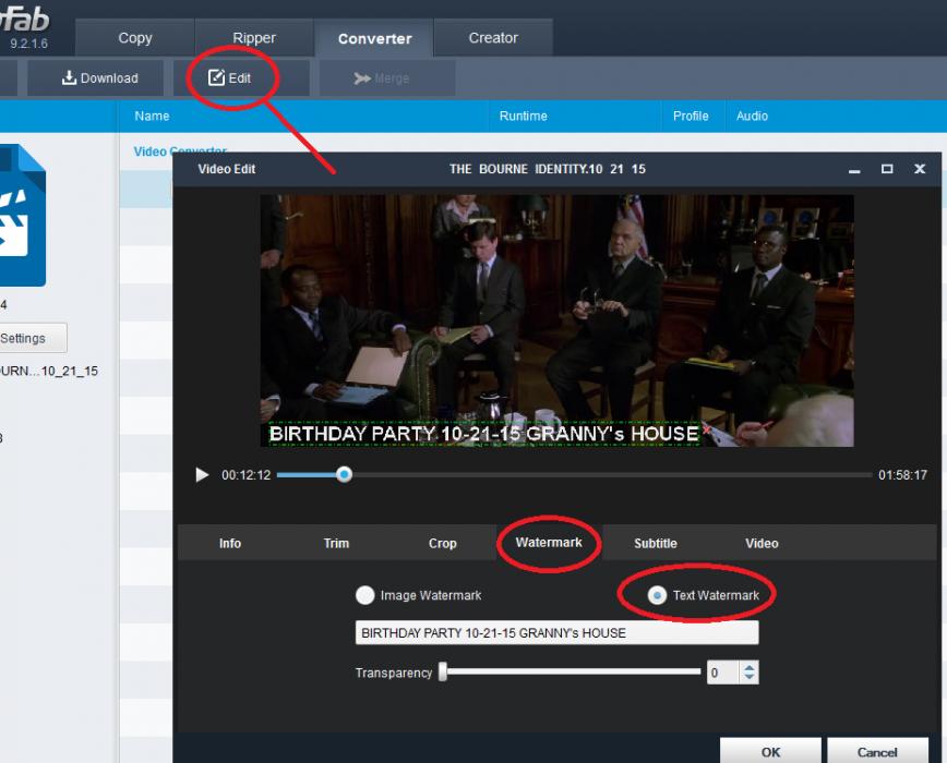

    2) Use the Watermarking feature to display the date and other info in the video itself, on the screen. This is permanent and can't be lost or changed. You can position it anywhere in the frame and choose the size and other characteristics. The green lines around the box are not included in the watermark, they represent the edit area.
      Thanks for your suggestions. Your first idea also has another benefit. Sometimes when copying files over the years, or restoring backups, file dates get lost anyways. By putting it in the file name itself, you can't lose it regardless of what happens to your files being moved/copied/restored etc.
