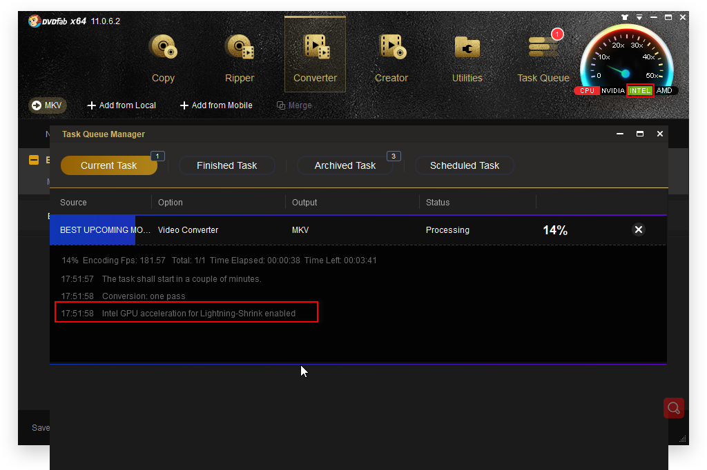

        From the log file, IQS is used for conversion on your computer.
        You can see the status when converting. see the attached pic.Click image for larger version
Name:	11-29-2019 5-52-43 PM.png
