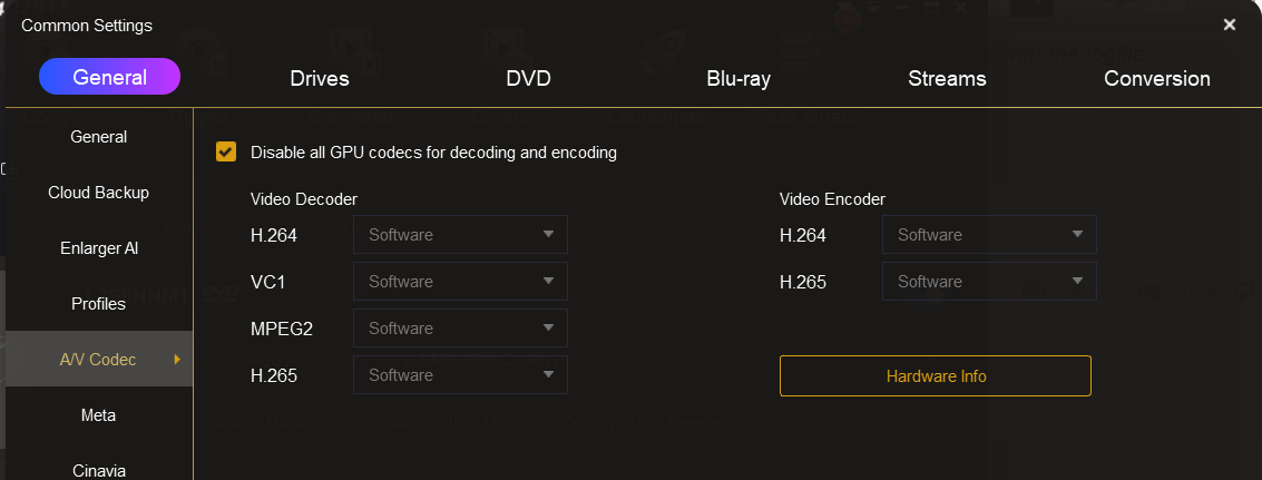

        Sorry, I do not understand. I use DVDfab > Converter only. No hardware, no other Software.
          Please go to Common Settings > General > A/V Codec, tick the option "Disable all GPU codecs for decoding and encoding"

            This works. It takes a lot of time, but it works. Thank you.

                It is not intended as a permanent solution, it is a temporary workaround. Please refrain from offering opinions which have no factual basis and from posting them in threads started by others.

                  Please update the driver of your graphics card and then enable GPU hardware acceleration to try again. If still have the same issue, we will need the video source to check it out.
                  Also, the latest log files are needed, thanks.
