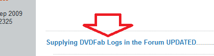

            didn't see a sig to get the link to log instructions
              If you don't see this below my post
              Just use this link: http://forum.dvdfab.cn/showpost.php?...40&postcount=5
