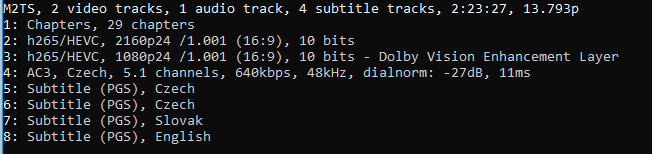

    Strange... extended info on title from eac3to gives me this...
    Code:
    M2TS, 2 video tracks, 2 audio tracks, 3 subtitle tracks, 2:23:27
    1: Chapters, 29 chapters
    2: h265/HEVC, unknown parameters
    3: h265/HEVC, unknown parameters
    BDinfo from DVDFab shows ok.

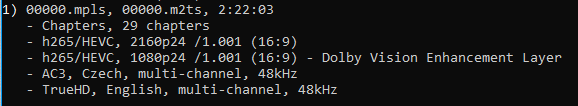

          So... basic eac3to info in created UHD BD folder:
          And... extended info on title 1)
          English Atmos/TrueHD/Core track gone...

          Resulting m2ts in stream folder:
          Code:
          Format                                   : BDAV
          Format/Info                              : Blu-ray Video
          File size                                : 73.1 GiB
          Duration                                 : 3 h 33 min

            any idea, why ATMOS/THD/AC3 track is skipped? Apparently, in MPLS is listed, in M2TS is missing.
              To my knowledge, it should be present in the output and I will send the developers a link to your thread, sorry for the problem.
                Hi jlp,
                The missing audio track problem is fixed, please update to v10.0.8.9 version to try again.
