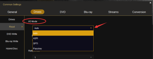

                              Hi walkerx, please try to adjust the I/O mode under DVDFab Common Settings>Drives>Read in DVDFab 11 to have a try and see if it will make a difference.
