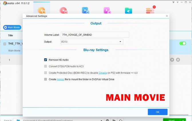

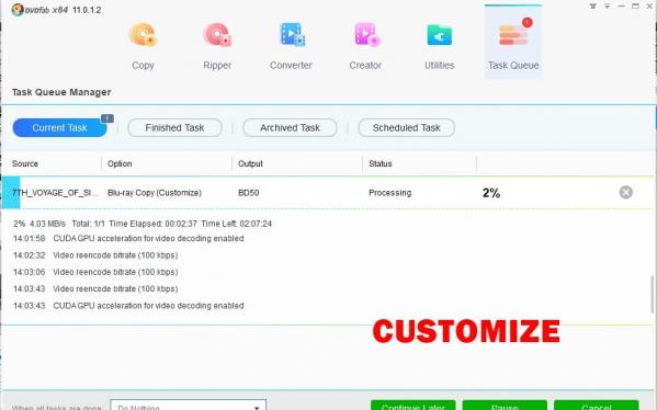

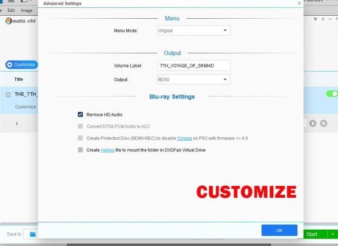

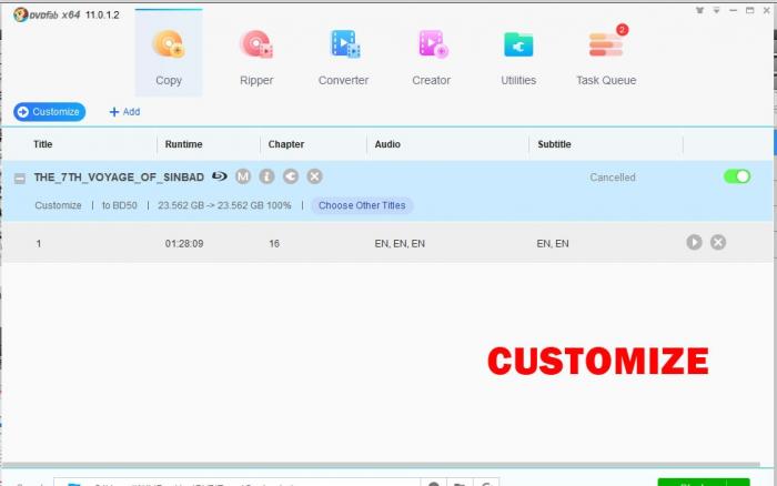

          I tried it with a commercial blu ray. The movie is less than 20GB. I am including screen shots showing my settings and results. In Customize Mode you can see that I have the setting on BD50 and am choosing only the main feature. It has enabled CUDA decoding and the data rate is around 3-4 mbs and time span of the copy is around 2 hours which indicates compression to me. Why isn't it directly copying?

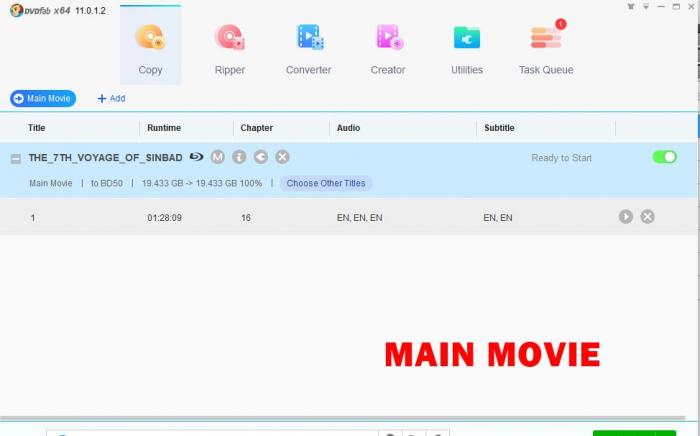

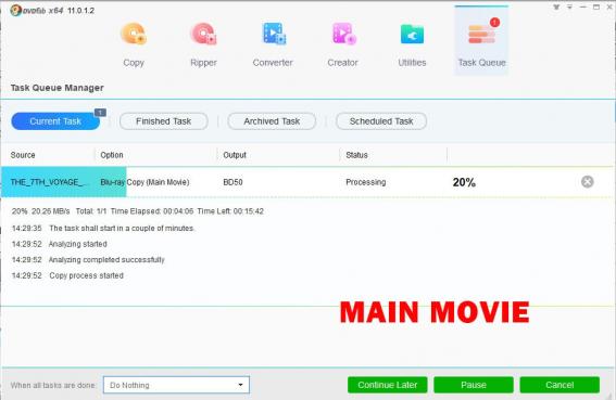

          In the following post I show the same operation in MAIN MOVIE mode. There is no CUDA decoding and the data rate is 20+mbs and the copy time is under 30 minutes. THAT is a direct copy. Unless I am misunderstanding it, why should Customize mode ALWAYS invoke compression when there is clearly no need?

            Here is the same movie using Main Movie mode.

              Hi Gondorff,
              Your understanding is correct. These is currently how Blu-ray Customize mode works, I will pass this to our developers and we will try to implement it in the future. Thank you for your report.

                  I tried running the copy through to completion to see if it would return to No Compression Needed at some point. I used the same disk and only activated the main movie and original menu.
                  Started copy - CUDA was activated - speed around 4+ mbs.
                  At the 40% point - 30 minutes after starting - it reverted to No compression needed and stayed in that mode through completion. Now the speed was 14+ mbs (much faster than before but still slower than Main Movie copy speed). Remaining 60% finished 30 minutes later for a total time of 60 minutes.
                  Although I'm glad that it does the majority of copying in No compression mode for a disk that needs no compression, I wonder why so much - 40% - needs to be reencoded when it's only the menu and the movie itself.
