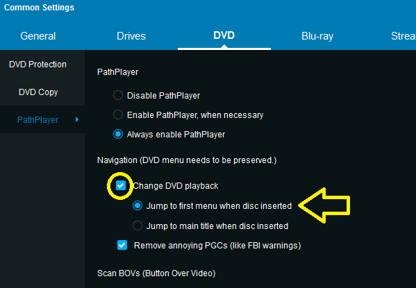

          Hi Hans,
          The DVD version works the way you want with PathPlayer enabled (see the capture), but note that it is hidden in Common Settings, not where it should be IMHO but at least still available. Unfortunately there is nothing similar for Blu-ray.
          Click image for larger version  Name:	1-011 DVDJMP.png Views:	1 Size:	20.7 KB ID:	340256
          The 'Jump to first menu...' works very well except for the odd disc that has a "pre-menu" with a language choice or one of the Disney Fast Play menus (not sure if they still have those). The 'Remove annoying PGCs' is not really needed if either 'Jump to...' is selected. These also work in Full Disc copy mode.
            Yeah, but -as you mentioned - this is DVD, nit BD. :-(
              Sorry, perhaps it can be added at some future point. An alternative might be the DVDFab Menu Generator which is available in BD Customize mode on the Advanced Settings page. Looks nothing like the original menus but will allow you to select the content you have chosen to copy..You can see it in the capture in post #3 ('Custom' menu type).
