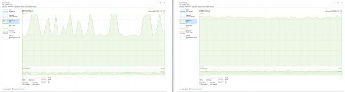

When using DVDFab to do a “Passthrough” of the UHD Black Hawk Down ISO to MKV (possibly MT2S or MP4 as well) the copy rate is slow. I’ve found this is due to DVDFab not using the HDD’s resources very well while it’s copying. To test this, I’ve used a competitor’s software, in this case MakeMKV and compared the HDD resource consumption between both. I’ve attached a side by side screenshot showing the percentage of the HDD’s activity during a DVDFab passthrough and a MakeMKV passthrough with the same settings applied to each. DVDFab is on the left and MakeMKV is on the right. The graph is a 60 second real time HDD usage from Windows Task Manager taking in the middle of each run. The MakeMKV passthrough has a much faster completion rate than the DVDFab passthrough. This is reflected in the HDD being used more by MakeMKV as seen in the screenshot. Since no encoding is being applied here I think maybe some optimization could be made to DVDFab to utilize the HDD more and achieve faster completion rates like MakeMKV.
