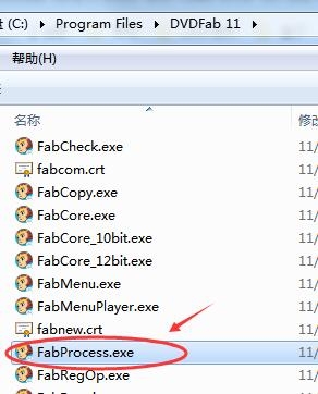

          Hi zeke009, sorry for the trouble, we've known where the problem is now, and have fixed it, but need to wait for the coming version. Please kindly wait for update.
          For now you can go to where you installed DVDFab, rename the file "fabprocess.exe" as a workaround.
            That worked, thank you.
