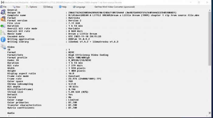

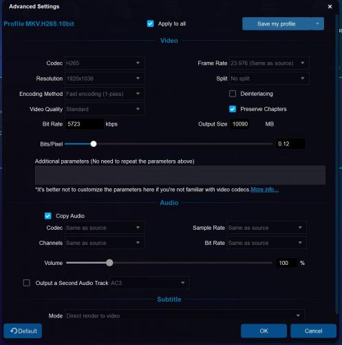

      I just used a full copy source file to rip just chapter 1 and it still ripped the entire movie.
      I used the correct profile, MKV.H265.10bit
Name:	Screenshot 2022-11-18 151501.jpg
Name:	Screenshot 2022-11-18 152524.jpg
      Attached are the logs and mediainfo file.
      Not sure what else I can do to get this to work for me.
      Hopefully your developers can figure it out.
      Thanks

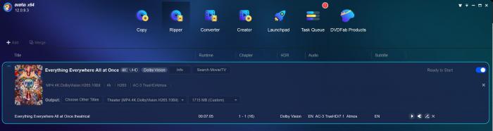

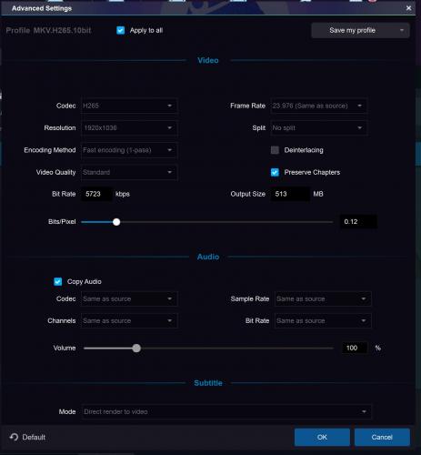

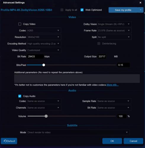

          So I tried to resolve this issue of not being able to rip selected chapters of any title whether it's a bluray or UHD disc.
          I completely uninstalled DVDFab and all its folders. I then rebooted and installed a new download of 12.0.9.3.
          I used the UHD disc of Everything Everywhere All at Once (2022) to try and rip just the 1st chapter of that title.
          I used the preselected profile MP4.4K.DolbyVision.H265.10Bit and adjusted the profile with the following attributes:
          - Web Optimized box checked
          - High Quality Encoding (2 pass)
          - Video Quality Customized with Bits/Pixel set to .15
          - Copy Audio (which is in Atmos)
          - Subtitles set to Direct Render to Video
          Click image for larger version  Name:	Screenshot 2022-12-06 224615.jpg Views:	0 Size:	15.1 KB ID:	418629
          Click image for larger version  Name:	Screenshot 2022-12-06 223841.jpg Views:	0 Size:	25.0 KB ID:	418630
          I'm still unable to rip just a single chapter. I have absolutely no idea how you are able to rip just one chapter.
          Does the way I have the attributes of that profile affect DVDFab so that it will only rip the entire title?? Cause that's the only explanation I can think of.
          I thought maybe I needed to delete and reinstall DVDFab, but that obviously didn't help.
          I will try yet again, but this time with the bluray disc of that same movie and let whichever Profile DVDFab selects without touching the profile's attributes. I'll just change the chapter selection to only Chapter 1 and hit start.

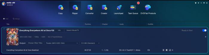

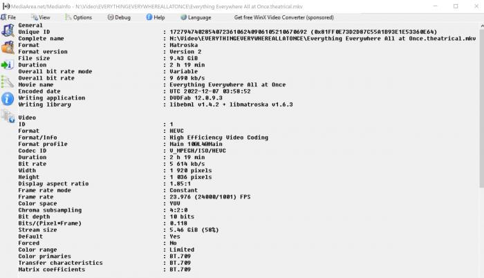

              So I just tried ripping the first chapter of the bluray disc of Everything Everywhere All at Once (2022).
              I used the Profile DVDFab selected without adjusting any of the attributes for that profile.
Name:	Screenshot 2022-12-06 225732.jpg
Name:	Screenshot 2022-12-06 225749.jpg
              Unfortunately, I still couldn't get just the 1st chapter to rip by itself. DVDFab will always rip the entire title no matter what I do.
              Here is the Mediainfo from this bluray rip showing the whole movie, 2hr 19mins:
Name:	Mediainfo Bluray title.jpg
              Why will this not work for me??
              I really need this feature to work. I'm wasting energy and time trying to make sure what Subtitle works when I choose the Subtitle Direct Render option.
              Please help.
              I've attached the logs again. Not sure why the attached logs aren't shown on the post.

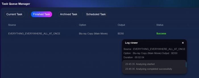

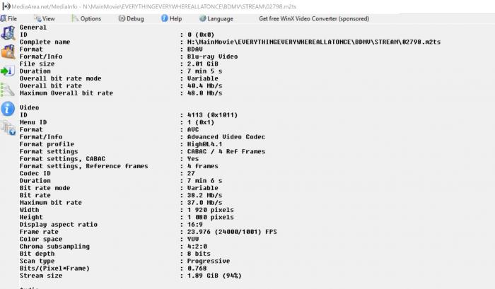

                I switched to using the Copy module instead of the Ripper tab just to see if that would only copy the first chapter and guess what, it worked! It only copied the first chapter.
                Here is the Mediainfo file for proof:
Name:	Mediainfo Bluray title Copy mode.jpg
                It shows only 7min 4 sec!
                So there is definitely something wrong with the Ripper module.
Name:	Screenshot 2022-12-06 235254.jpg
                Mona
                Could you have someone look into this?
                I'm attaching the logs from this session, but you'll see in the logs that I tried a whole bunch of different tests.
                Thanks

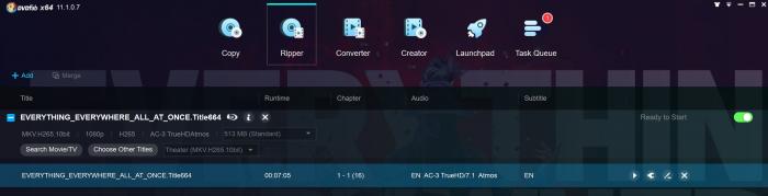

                      #25
                      Mona

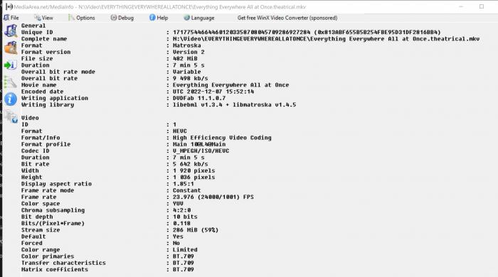

                      I uninstalled DVDFab 12 and installed DVDFab 11.1.0.7 to test october262 theory about DVDFab 12 being the problem and he was correct.
                      I can not rip a single chapter or multiple chapters in DVDFab 12 (any version in 12.x.x.x).
                      I can, however, rip a single or multiple chapters in DVDFab 11 (tested version 11.1.0.7).
                      So there is no problem with my computer.
                      There are no problems with any of the Profiles I use.
                      There are no problems with any of the video attributes I change in the Profiles I use, like 2 pass and custom Bits/Pixel, etc.
                      There is a software problem that occurred going from DVDFab 11 to DVDFab 12. I don't have time to test every version of DVDFab 12 to see where chapter selection ripping breaks, but at least your software developers can look at the code between DVDFab 11 and DVDFab 12 to see what changed.
                      Here are screenshots and the logs from my rip of Everything Everywhere All at Once (2022) bluray disc chapter 1:
Name:	Screenshot 2022-12-07 105033.jpg
Name:	Screenshot 2022-12-07 105134.jpg
Name:	Screenshot 2022-12-07 105504.jpg
                      You can see DVDFab 11.1.0.7 was used and it only ripped the selected Chapter 1. Took less then 3mins in my system.
                      This is expected behavior. I'm really hoping your developers can figure this out and put out a new version with the fix.
