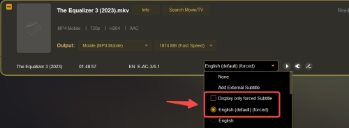

                          Please Select English (default) (forced), and uncheck Display Only Forced Subtitle to try it again, thanks.
                            Tried with above settings. Conversion ran over 30 minutes. Using 2 different video programs, neither showed any subtitles.
