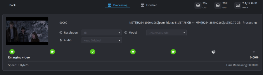

        Just loaded 3.0.0.0 and am running it now. Still stuck at zero progress (after nearly 30 mins.) when doing an upscale to 4K. The little blue circle spins, but nothing else (% or Time Remaining) advances. Functionality is now stripped down to the bare minimum. No more ability for user to adjust bitrates and other output options. This is even worse than 2.0.3.8. How is this a "Next-Level Experience". I guess you could say it is if you're in an elevator headed to the basement from the upper floor! I'd be ashamed to release this software to the users. It's an attractive interface, but void of functionality, user controls, and reliability.

                  Did another trial run of Version 3.0.0.0. This time I tried using it with a smaller video (shorter duration of less than 5 minutes). This time I did find that the "% Completed" and "Time Remaining" did increment/decrement accordingly. After that, I tried it out with a full-length movie slightly over 2 hours duration. That's when it gets caught in what seems to be a "no progress" noted situation.

                  For this feature length movie, it has been roughly 30+ minutes where the Time Remaining and % Completed are stuck at ZERO progress. This gives the user the impression that nothing is happening or that the application is stuck in some kind of indefinite/infinite loop. My guess is that the application is probably doing some kind of analysis of the video prior to actually re-encoding it and during that period of time the progress remains at a stand-still. This would explain that when running the 4K Upscale on the shorter duration video, the analysis doesn't take long to complete before the processing engages and the progress (% and Time Remaining) reflects incrementing/decrementing as one would expect. If this is the cause of this issue, there should some kind of progress visual that lets the user know what is going on. Maybe there needs to be a separate step for any pre-analysis (before actually processing the video to upscale, etc.) with its own progress visual before moving it forward along the progress line to actual processing of the video.
                    #24
                    Did some further testing and have determined that it isn't due to the size (duration) of the video source after all. Apparently, it is tied to the M2TS file. It doesn't like the M2TS file format of the source video file and gets hung up. If I convert it to an MKV format, it quickly jumps through its pre-processing/analysis phases and then starts processing with the process status visuals appropriately reflecting actual progress status. The work around is convert the M2TS file to MKV and process that instead. That is an obvious issue as, per the software you should be able to use a native M2TS file format for processing.
