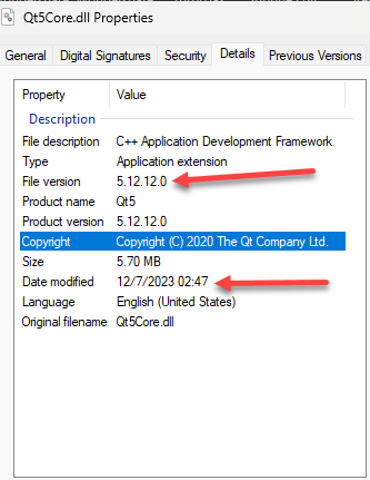

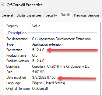

    I agree the culprit is an out of date Qt5Core.dll file. For me, though, it seems that the install would have updated it had something else not been preventing it.
    I tried Jack’s method, but when I got to reinstalling version 6.1.4.9, my Qt5Core.dll File Version (5.12.4.0) and Date modified (3/3/2022) had not changed, so I suspected something was preventing the update.
    On a whim, I tried to delete Qt5core.dll -- I know, reckless and not advisable, but it did tell me could not delete because it was in use by another program. The program was StreamUpdate.exe.
    Somewhere along the line StreamUpdate.exe got stuck and was always running, once I killed that process and reinstalled 6.1.4.9, the File Version (5.12.12.0) and Date modified (11/9/23) had changed, which is correct.
    I then offline installed 6.1.5.3 overtop of 6.1.4.9 and only the date changed (12/7/23 – release date of 6.1.5.3).
    Once the Qt5Core.dll was properly updated for me, version 6.1.5.3 was working well for me. I was able to successfully download season 4 of Will & Grace (27 episodes) all in one go with no abnormal terminations.
    Qt5Core.dll is located wherever you install StreamFab.
    For me, this is: C:\Program Files\DVDFab\StreamFab
    Qt5Core.dll for StreamFab is located here, scroll down to it right click it and pick Properties to check File Version and Date Modified.
    That having been said:
    Here’s what I think you should might try first, hoping that it’s the easiest way based on the previous rationale:
    1. Open Task Manager
    2. Look for program StreamUpdate.exe – was preventing any update to Qt5Core.dll for me.
    3. Right-click End task.
    4. Re-Install 6.1.4.9 offline (see above how to check if the right version of Qt5Core.dll is installed).
    File Version should now be 5.12.12.0 and Date Modified should be 11/9/23.
    Not sure this step is really needed. May just be able to reinstall 6.1.5.3 overtop of 6.1.5.3.
    1. Offline install 6.1.5.3 overtop of 6.1.4.9 (or 6.1.5.3 as mentioned above).
    2. Check that File version is still 5.12.12.0 and Date Modified is 12/7/2023.
    3. Start Streamfab and test.
    I hope this helps you mattmuck
    I guess I'm going to check Task Manager for StreamUpdate.exe and kill it before I do any future updates.
    Thanks to Jack for pioneering this and to Cats4U for proving insight into the issue.

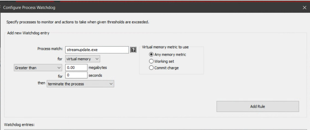

                              I'm interested in how you have automated the watching for and shutting down StreamUpdate as you mentioned above
                              I thought about some type of batch program that runs in a schedule task, but wasn't sure what to put in the batch program. Also, I did shut off StreamUpdate in Windows settings startup, but don't think that will catch the one that starts when StreamFab starts, or If I would accidentally pick it from the StreamFab drop down.
                              So, anything you could tell me about how you do this or anything you feel comfortable sharing with me so I can implement the same, would be greatly appreciated.
                              Thank you again.​
                                KurtH3,
                                I currently have my private messages turned off due to prior abuse from some forum users. Rather than get them banned I just shut off the ability for them to privately abuse me. I may turn on PM again sometime in the future.
                                I use a program called Process Lasso. It is basically a Task Manager on steroids. One of the tools it offers is a process watchdog. It has many functions including turning on or off different processes based on several different factors.
Name:	Screenshot 2023-12-12 10.01.57 AM.png
                                Process Lasso is a pay program but there are several free programs that will also do the job. Google "windows process watchdog" for some possibilities including Process Monitor by Sysinternals which is released by Microsoft.
                                You could probably also use a batch file but that is working at the Program level and I prefer to deal with processes at the OS level.
