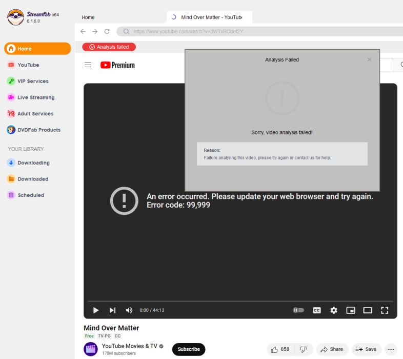

New YouTube Movies error: "update your web browser and try again. Error code: 99,999"
    YouTube Movies New YouTube Movies error: "update your web browser and try again. Error code: 99,999"
    Trying to download this free to watch title: https://www.youtube.com/watch?v=3WTxRCdef2Y
    It gives this result:
    Click image for larger version  Name:	error.png Views:	18 Size:	92.2 KB ID:	435860
    This error actually occurs outside of StreamFab, in a regular web browser as well.
    This error is pretty new. I was only able to find this URL with some discussion about this error:
    https://mstdn.social/@Linux_Is_Best/111750209336123949
    I tried following the instruction in the message to update the browser. I downloaded the latest Google Chrome Portable, which at the time of this writing is 121.0.6167.86:
    https://portableapps.com/apps/internet/google-chrome-portable-64
    I ran it, put in the above YouTube URL, and sure enough, it played!
    I did try the temporary CEF fix... it had no effect on this problem in StreamFab.
    I also tried clearing the StreamFab temp folder... that also had no effect.
    So, it appears that StreamFab needs to be updated in order to work with YouTube Movie titles that are giving this error.
    Of course I am aware of the latest DRM updates that are affecting StreamFab. I'm not sure if this is related, so I know it may be some time before this can be fixed. :\
    If I replace WidevineCdm in AppData\Local\CEF (version 4.10.2557.0) with the one from the latest Google Chrome 121.0.6167.86 (version 4.10.2710.0), then the video plays in StreamFab, but it still gives the above grey "Analysis Failed" error box.
    So, it would appear that StreamFab needs to support WidevineCdm version 4.10.2710.0 in order to be able to download YouTube Movies now.

        I ran the application updater to 6.1.6.1 and got the same "Error code: 99,999" error in the YouTube player in StreamFab. I noticed that the files in AppData\Local\CEF were the same after I ran the update. Widevine was still at version 4.10.2557.0. I double checked and StreamFab said it was at 6.1.6.1.
        I didn't trust it and ran a complete uninstall, and manually went around and deleted leftover DVDFab directories, the AppData\Local\CEF directory, and DVDFab registry keys, so that I would be installing from scratch. I downloaded the full StreamFab 6.1.6.1 installer, and afterwards checked and found that the AppData\Local\CEF directory was in fact supposed to update, as now Widevine is at version 4.10.2710.0.
        I don't know why the AppData\Local\CEF directory didn't update after running the StreamFab updater... I had replaced the AppData\Local\CEF directory with the one from the temporary CEF fix, so maybe that had something to do with it? Anyway, you might want to check to make sure users running the updater aren't left with old versions of Widevine! (This is why I personally prefer to always do a complete uninstall and reinstall of any software, and manually re-enter settings... it takes more time but helps avoid these kinds of things.)
        It didn't fix the YouTube problem reported in the original post, and I didn't expect it to, given the top announcement in red text. But, StreamFab isn't consistent as it will fail in one of three ways:
        1) Video plays in StreamFab, but gives grey "Analysis Failed" box shown in original post.
        2) Video plays in StreamFab, gives white and orange "Analyzing video URL" box, which stays on screen and does nothing until the "Cancel" button is pressed.
        2) Video starts to play in StreamFab but then StreamFab.exe crashes:
        Code:
        Faulting application name: StreamFab64.exe, version: 6.1.6.1, time stamp: 0x65b320be
        Faulting module name: ucrtbase.dll, version: 10.0.19041.789, time stamp: 0x2bd748bf
        Exception code: 0xc0000409
        Fault offset: 0x0000000000071208
        Faulting process id: 0x2434
        Faulting application start time: 0x01da50d59f311bb4
        Faulting application path: C:\Program Files\DVDFab\StreamFab\StreamFab64.exe
        Faulting module path: C:\WINDOWS\System32\ucrtbase.dll
        Report Id: 277f7467-7027-48ac-9770-612a9339bf7d
        Faulting package full name:
        Faulting package-relative application ID:​

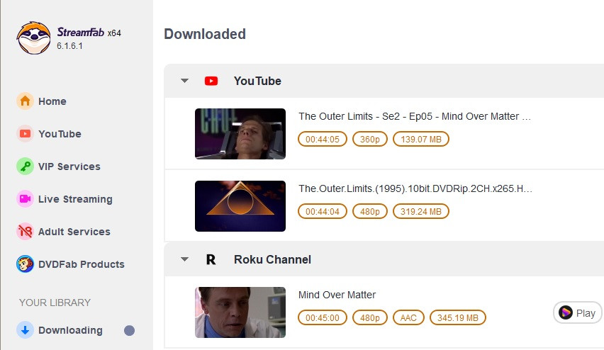

                    Me again - small addition:
                    If you have "Roku Channel Downloader" - this works currently in SF:
                    The Outer Limits (1995) s02e05 https://therokuchannel.roku.com/watc...d507ca2572aa8c
Name:	The Outer Limits_s02e05.jpg
                    if not bad quality - see post #6​
                      Thanks Germania, that helps but Roku downloads are poor quality (HD, but very low bit rate). That's why I was trying to get the YouTube DRM download.
