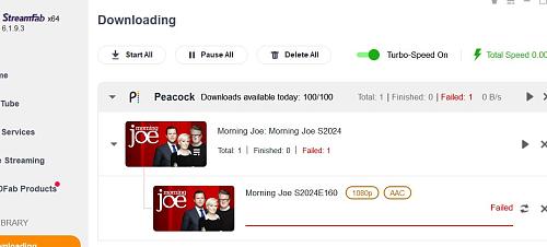

                      Still getting failures on the MSNBC in 6193 on the news/talk/opinion type shows such as Morning Joe, All in with Chris Hays and so on.. Sometimes they work, sometimes they fail. Multiple attempts seem to eventually work but it can be a PITA.Seems to be just the MSNBC shows. Now the progress bar turns red when the download fails, in 6192 the progress bar remained blank - did not show anything if the download failed.

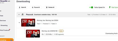

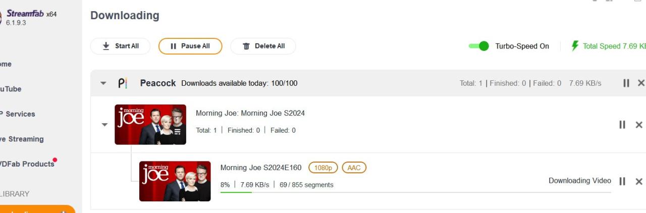

                            #74
                            When you say failure (other than the newly reported red line), what are you seeing?
                            Only difference that I see is that in 6193 the progress bar changes to red at the end of the download when it fails. In 6192 nothing showed in the progress bar, never showed any green. Sometimes when the downloads fail it takes quite a few tries to successfully complete but every now and then they complete on the first attempt. No issues with any other TV shows or movies, just the MSNBC news/talk/opinion type shows.
                            Pre 6190 I experienced no issues downloading MSNBC news/talk/opinion type shows.
                            Click image for larger version  Name:	Peacock 1.jpg Views:	0 Size:	42.2 KB ID:	447932
                            Click image for larger version  Name:	Peacock 2.jpg Views:	0 Size:	42.3 KB ID:	447933
                            Click image for larger version  Name:	Peacock 3.jpg Views:	0 Size:	86.1 KB ID:	447934
                              #75
                              It looks like you don't have the 0% and 0 segments (I mistakenly called them packets in my last message) problem that was fixed in 6.1.9.3. You have something else. I still didn't get a chance to run my tests on MSNBC yet. I'll get back to you.
