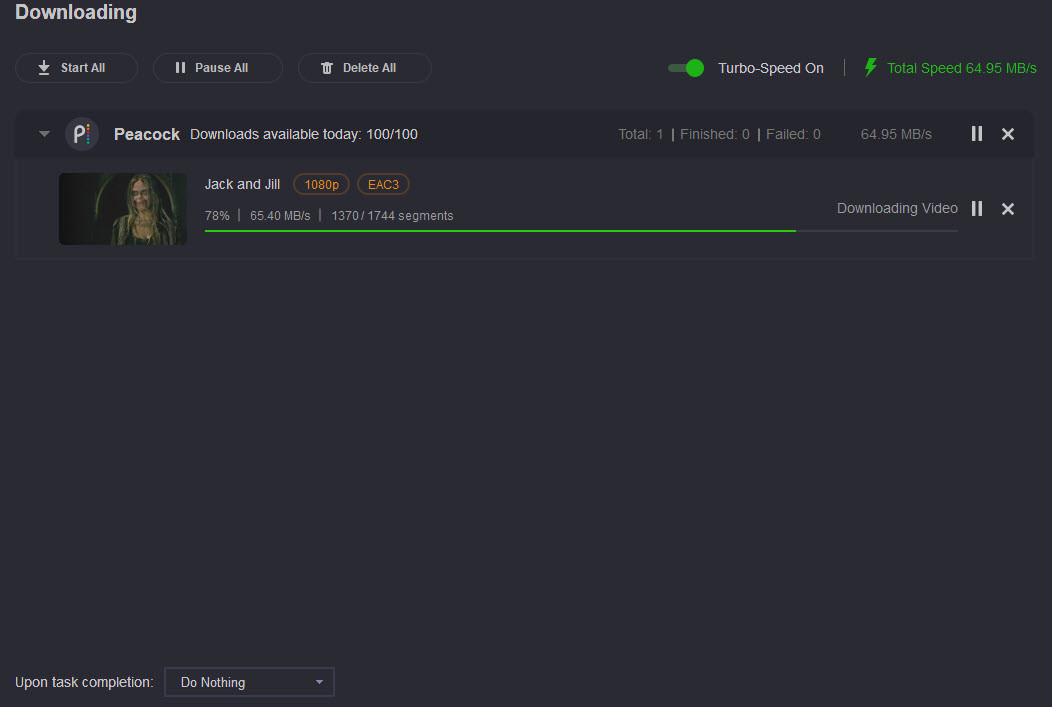

                Worked fine the first time, with no issues.
                Click image for larger version  Name:	2024-08-12_17-35-05.jpg Views:	0 Size:	48.7 KB ID:	448056

                          It's very strange, but Peacock has never been so perfect for me as it is now. I downloaded 50 different things over 3 days. I just woke up and got this one, and the speed is great, the picture is great, and everything works fine. 6.1.9.3 is the first one where all my providers work perfectly. The speed is totally great and so fast I cant believe it, the movies play fine.
                          Peacock, MAX, Paramount+, Hulu, Amazon, Disney, and Netflix are all perfect.
                          Click image for larger version  Name:	Peacock.jpg Views:	0 Size:	68.4 KB ID:	448256
