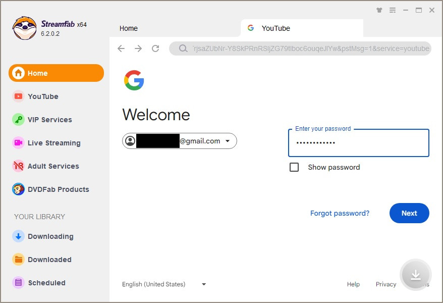

          #19
          Originally posted by Chris5626 View Post
          When trying to sign in to YouTube (UK) via StreamFab the Google account sign in screen appears but only for a few seconds (not fast enough to type your email but you can copy and paste it) when you proceed (before even putting a password in) it says the browser or app may not be secure.
          With the latest version of StreamFab after inputting your Google account it does actually go to the password entry screen but there isn't enough time to input it before it goes back to YouTube (with you not being signed in).
          I've tested about a dozen times, you have about 4 seconds to input your password and your email/username in total however that includes the time for the Google sign in page to load and transition from your email/username to your password, even copying and pasting my email that isn't enough time for me to input it.
          Feels like a tiny step forward though.
          No, it's supposed to do that! You're not actually supposed to enter anything on the YouTube sign in screen in StreamFab. If you hurry and copy and paste your e-mail and password, you will get the "may not be secure" message; that is expected behavior. When you click the sign-in button on YouTube in StreamFab, that is where it is supposed to import the cookies from either Chrome or Edge, then it refreshes and you *should* be signed in at that point.​ Except, in 6.2.0.2 it's no longer working for me, so when it refreshes it's still at the same "Try searching to get started" page and it is **not** logged in.
          It looks like a bug in 6.2.0.2.
          Boy am I sorry I updated.

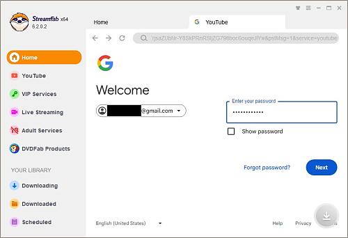

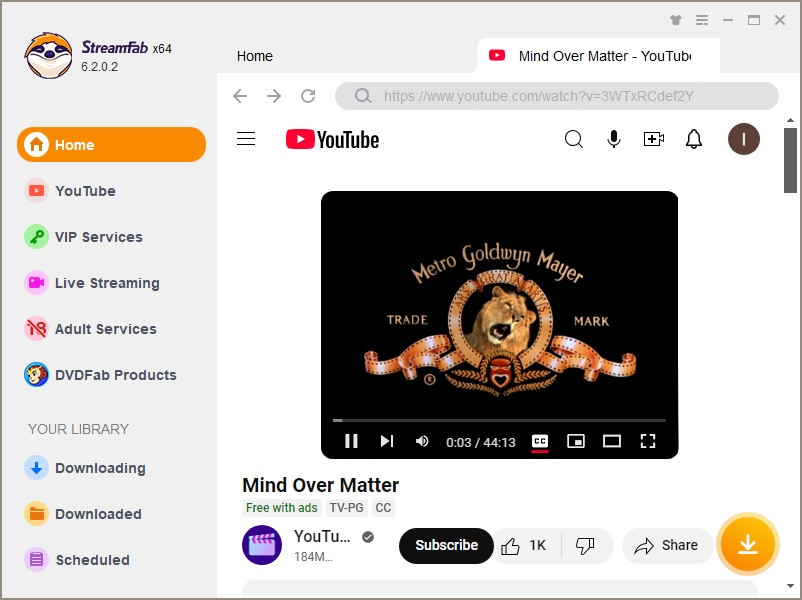

            #20
            I've no login issue direct in 6202 ..

              It looks like you're logging in to Google from inside StreamFab? That won't work if that's what you're doing. You open the YouTube downloader in StreamFab, click the "Sign In" button, then wait as StreamFab imports cookies from either Chrome or Edge. The screen refreshes and you should be logged in. If it doesn't work, it usually can be fixed by closing StreamFab, then opening Edge and/or Chrome, completely clearing the browser cookies as well as history, cache, etc., then going back to YouTube in Edge and/or Chrome and logging in. That will completely reset the cookies with fresh data. You then start StreamFab, click the YouTube downloader, click Sign In, then it should import those cookies, refresh, and you should now be signed in. Except, that's not working in 6.2.0.2.

                #22
                And why am I signed in if I have never used the account outside of SF?
                I created the account with App for Android and never used in any win browser.
                It was the same with 6201 - see post #2

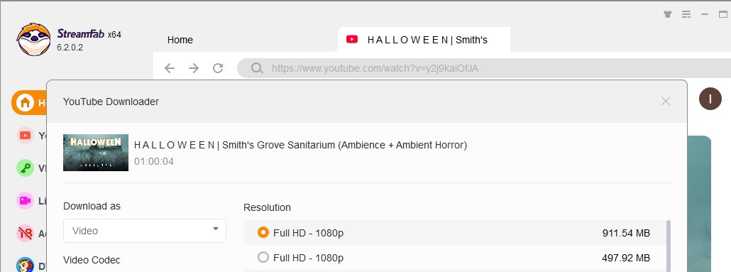

                      #25
                      > If you're logging in directly inside StreamFab like you're showing then downloads won't work properly
                      Oh, you said before that it doesn't work at all ..
                      > Can you download anything?
                      Videos wihout DRM works fine (need sometimes for age verification)​
                      -=click pic to enlarge =-

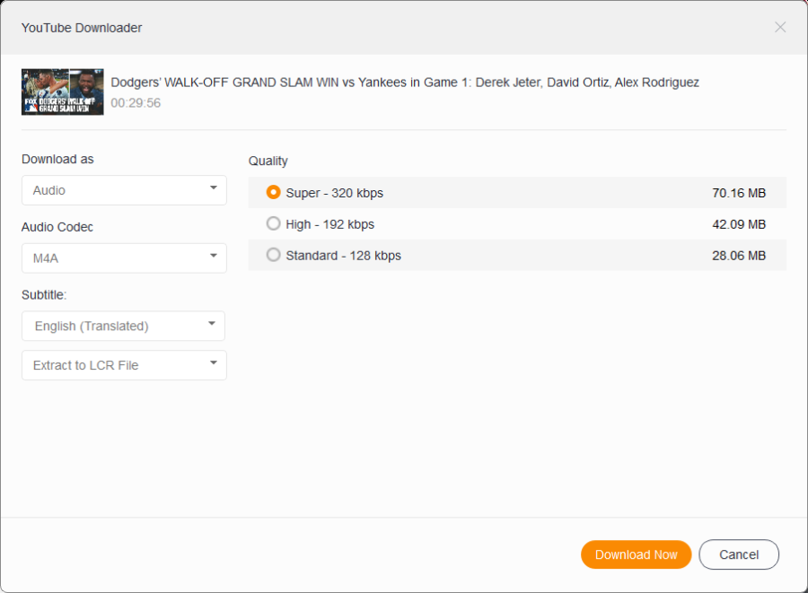

                          #27
                          I completely uninstalled 6.2.0.1 and installed 6.2.0.2 again.
                          I tried saving the StreamFab Temp folder after it had imported cookies in 6.2.0.1. After installing 6.2.0.2, I tried clearing the Temp folder and copying the saved Temp folder from 6.2.0.1 into the Temp folder for 6.2.0.2. This didn't work. YouTube was logged out and cookie importing from Chrome or Edge doesn't work.
                          However, this time, if I log in to Google inside of StreamFab, then go to YouTube, now I am getting the same thing as you... I can download non-DRM content including video, audio, and subtitles. Not sure why it was only offering Audio before.
                          One thing though:
                          Click image for larger version  Name:	st_yt_audio.png Views:	6 Size:	76.3 KB ID:	452225
                          I selected "Audio" for "Download As" and it shows 192 and 320 kbps streams. For non-DRM downloads, I don't believe these exist. Max quality YouTube audio streams are 128 kbps for M4A and vary for Opus, usually around 150 kbps. There is *no* 192 or 320 kbps. You can verify that with yt-dlp. So what is the 192 and 320 kbps that StreamFab shows for every video? StreamFab must be re-encoding it. Which doesn't improve the quality. Are they doing this just for marketing, so that they can say it saves YouTube audio in 320 kbps? I have no idea. StreamFab also offers "MP3" for audio codec which YouTube doesn't use, so StreamFab must be re-encoding it, again probably for marketing so they can say it saves YouTube audio as MP3. Again I have no idea. This is one big reason why I don't download non-DRM YouTube videos with StreamFab, and instead use yt-dlp.
                          Sorry for the sidetracking. The main issue is that Google/YouTube cookie import from Chrome or Edge is not working in 6.2.0.2, even though StreamFab.log shows "sync cookie success".
