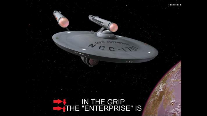

    Some downloads from Netflix has subtitles showed in reverse order. Must say I use .SRT subtitles;
Name:	StreamFab Netflix subtitles.png
    As you can see, the order of texts are wrong. The right subtitle is "THE ENTERPRISE IS IN THE GRIP".
    It happens in several downloads of different TV series/movies but others are perfectly functional.
    These failure is caused by an error in .SRT files. It occurs because the two (or three, or more) lines of text has the exact same start and ending time. To avoid this, all these lines should be in one time stamp only, but they have time stamps for each one (with the same starting/ending time)
    See below (this time is a Star Trek TNG episode):

    If I change to muxed subtitles, it gets worse. Only one of the text lines is shown...
    Thank you in advance.

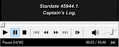

                    In mpc-hc Player is "Captain's Log," not at the top

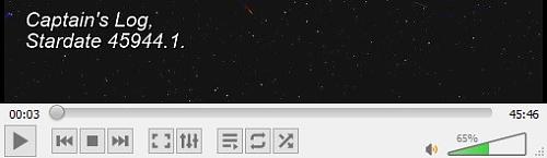

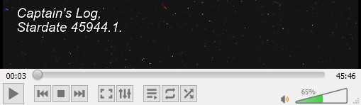

                    in vlc Player the order is correct but the position wrong
                    Click image for larger version  Name:	start_treck_tng_subs_vlc.jpg Views:	0 Size:	17.5 KB ID:	455829
                    And what I knew beforehand: In srt position + line is completly missing​
